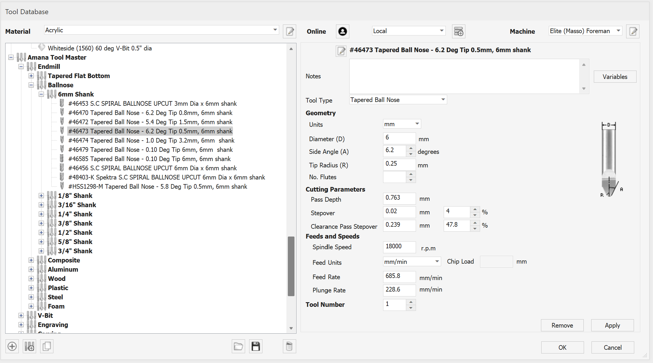

Can anyone help me out by giving me a tool setup for Vectric? The official data base from Amana doesnt have the 46473.
I really want to know what pass depth others are using and how well its working. I dont want to accidentally break a $70 bit trying a bunch of settings.

I also found this in the database. Note that all the values are metric.
