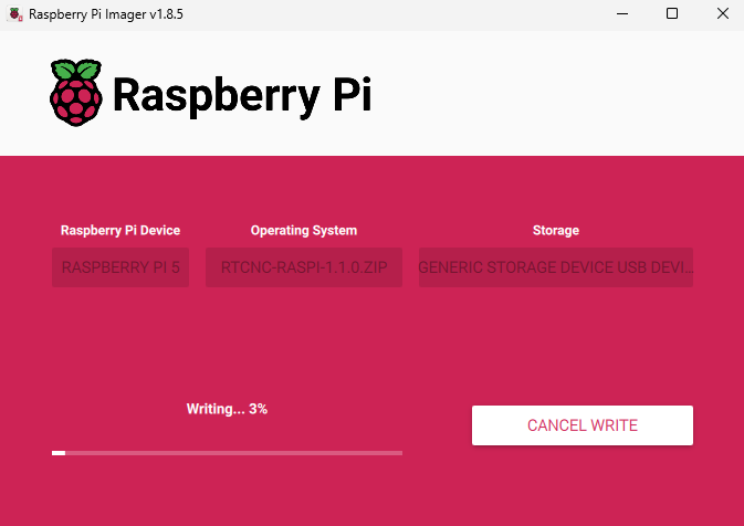

Step 4: Remove all external drives from your computer (sd cards, usb sticks, usb printers). Then insert your SD card you pulled out of your Onefinity Controller into your computer. (some computers do not have a slot for an sd card. You can purchase an adapter very inexpensively here: SD card reader)
Step 5: Open Raspberry Pi Imager.
- For the column “Select your Raspberry PI Device” choose “Raspberry Pi 5”. Hit NEXT.
Under ‘OS’ under Choose Operating System. Scroll down until you see 'Use Custom" and select it. A dialogue box will pop up directing you to select the image file previously downloaded in step 1.
Select the RTCNC SD Image (.zip file) you just downloaded above.
Step 6: Under Storage, Click CHOOSE STORAGE.
Now, select the sd card you put into your computer from the Onefinity Controller. (drive your Onefinity SD card is in) on your computer (Warning, this will delete EVERYTHING from the drive you select. BE SURE it’s the Onefinity SD card and not your personal drive as you WILL LOSE all of the data. Hit NEXT.
Choose to erase all data:
Step 7: Click WRITE! Please be paitent and do not cancel. It will finish.
Step 8: Ignore ALL popups (like “this drive needs to be formatted”, etc.) while etcher is running.
Step 9: After etchers progress bar fills up during ‘decompressing’, it will switch to ‘flashing’. After flashing, it will switch to ‘verifying’. Please wait patiently until all 3 of these processes finish. It’s best practice to not do anything on the computer from the moment you click ‘flash’ until the moment etcher finishes the job and says ‘success’.
Step 10: Once Imager finishes it should read, “Write Complete!” At this point, you can push FINISH and remove the SD card from your computer and reinsert it into the Onefinity controller. Remember, the wording on the sd card will face down, towards the bottom of the controller when reinstalling it from the top down.
