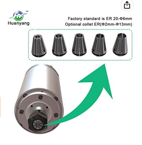

Looking for suggestion from any users with the HuanYang 2.2kw spindle . It has a ER20A nut. I am looking to purchase a couple of extra ER20A nuts that are of good quality. I have asked HuanYang but they have not responded. If you check Amazon they all have bad reviews for one reason or another. Any suggestions?

No I meant the Spindle Nut which is a ER20A on the Huanyang 22KW spindle. See documents from HuanYang.
Collet vs Nut
The collet is inside the ER20A and spindle center shaft. For the collets I already have a full set. The nut supplied from HuanYang is balanced and I would like to purchase additional balanced ER20A spindle nuts.

ah okay, sorry for the misunderstanding. I did not think of that because my collet nut was delivered with the spindle, I had no need to buy one. My spindle came with this nut that are also sold separately.
Aiph5u, My spindle also came with a clamping nut. I currently have two and want three. I want to set up with my commen used cutters 1/8" , 1/4" , 1/2". This way I can leave the collets in the clamping nut and just select the cutter.
