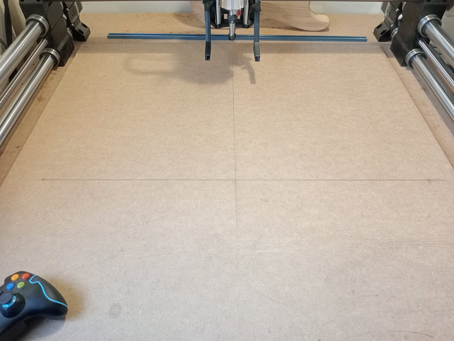

I´m having problems aligning my machine. No matter what, It´s not square!
I sent the machine to zero, go to the center and draw 4 points. When I measure the lines, they are not square.

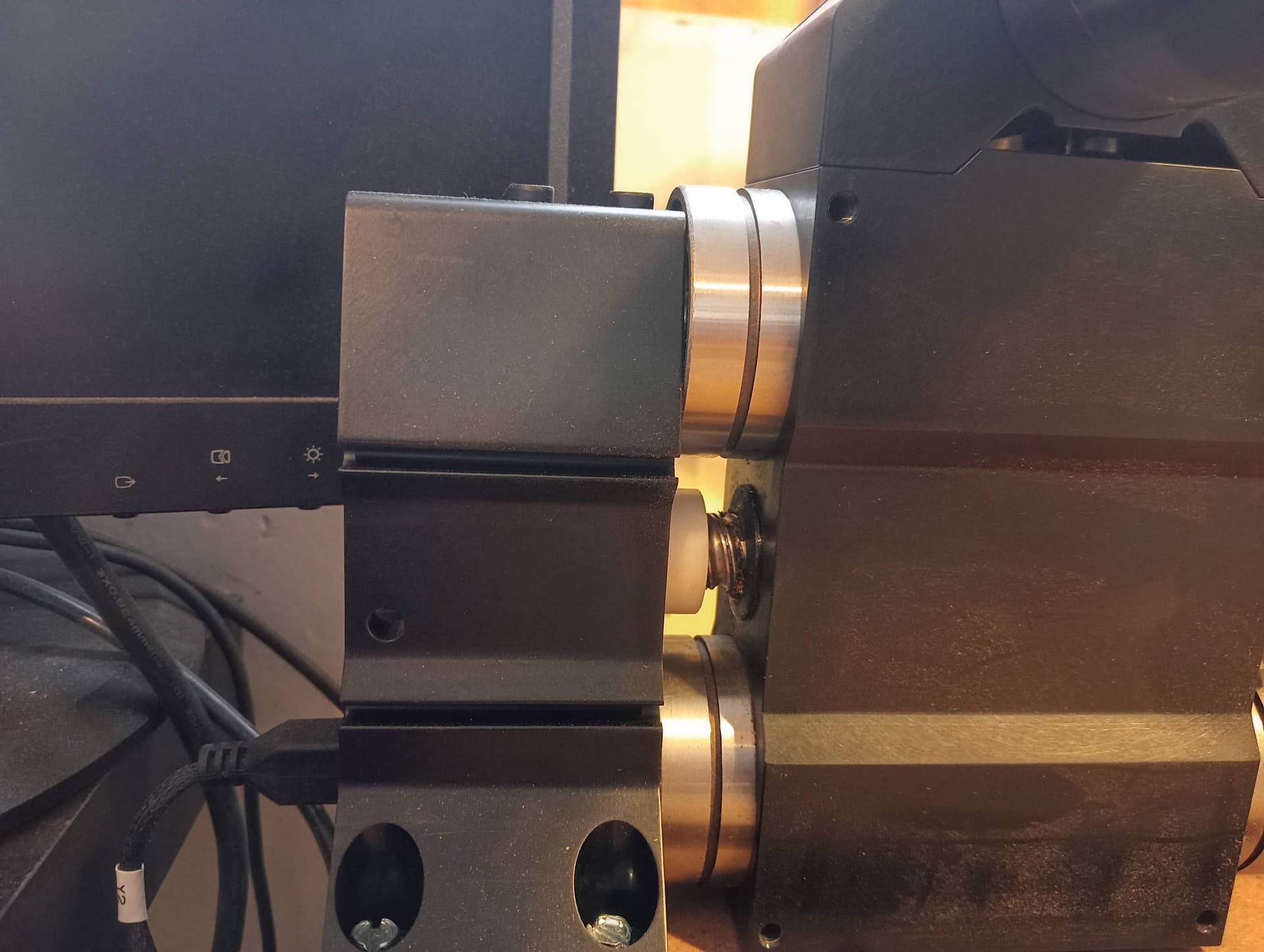

I’m attaching some pictures.
Hope someone can help me.
Thanks
Hey Toño,
this is a frequent problem, as the instructions to assemble the Onefinity do not provide a way to accurately square the machine. Therefore it is asked frequently and also discussed thoroughly. So I would search the forum for rectangularity (“squaring”), e.g. the other day I posted this answer.

Hey! I follow the steps and now is perfectly square!
