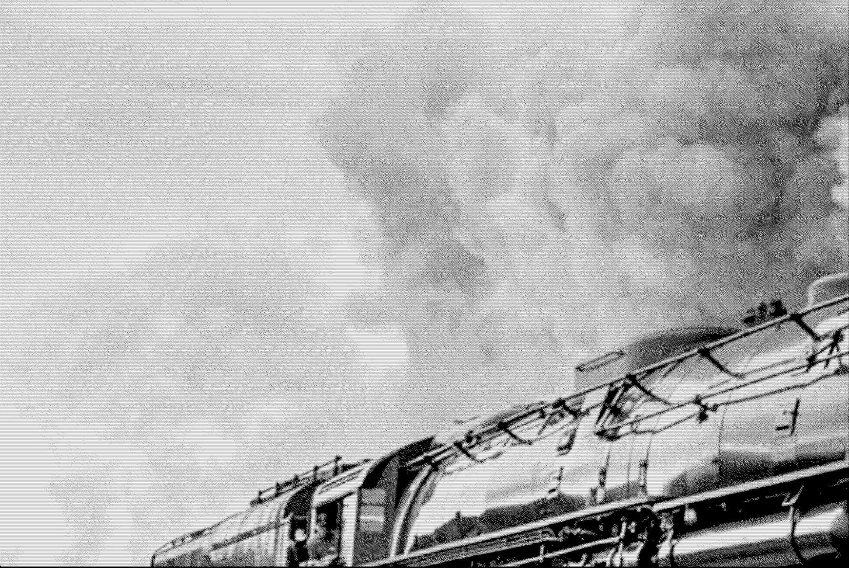

Having thought I had figured this out (albeit in a way that’s inconvenient), I ran into a new issue while lasering a photo onto a 12"x8" piece of slate. Referencing below, you can see that the circled portions (and more) have what appear to be streaks in them. Looking closer at the image, you can see that this is actually from the laser firing at a higher power than it should, causing areas with larger, whiter burns. I thought this may be from a poor signal to the controller, but the cable I used has excellent connectivity and is shielded and grounded. Not really sure how to go about this. The photos below don’t show the streaks that well, but in person the streaks are unfortunately very visible.
Slate with Streaks:
Slate with Streaks:
Lightburn Preview:
Lightburn Settings:
Any advice would be much appreciated!!
I’ve also tried power cycling the system, re-generating and re-uploading the code, and printing different segments. In the photo below you can see that the three middle sections have the streaks, whereas the bottom sections do not. The only major difference is that the middle segments have significantly more area to burn. Is it possible that the laser controller can’t keep up with 125mm/sec (295IPM) speeds?

With the help of Jay from JTech’s customer support we were able to figure out the issue(s).
Dithering images requires the laser to turn on and off repeatedly at a very high rate. My feed rate of 125mm/sec (300IPM) is too fast for image dithering. 40mm/sec (100IPM) is the sweet spot for dithering.
My original tool setting used “Laser (J Tech, ect)”.
Jay suggested that I switch to “PWM Spindle” and play around with the “pqm-freq” setting, making sure to not surpass a value of 3000.
I did a few tests with frequencies ranging from 1750 - 3000, finding a sweet spot at 2000 (this may differ for you). I also played around with the rapid-auto-off and dynamic power settings - these don’t effect the image as much but disabling them did seem to help a little bit.
Having said this, I still occasionally get higher power pulses when not expected. This is completely fixed if you replace all “S0” values with “S1” in the .gc file as mentioned above (I still make sure to keep “G1 S0” at the end of the code so the tool power is set to zero when the process is complete). The command S0 seems to shut the laser off, where S1 is low enough to not engrave the material and it keeps the laser on.
