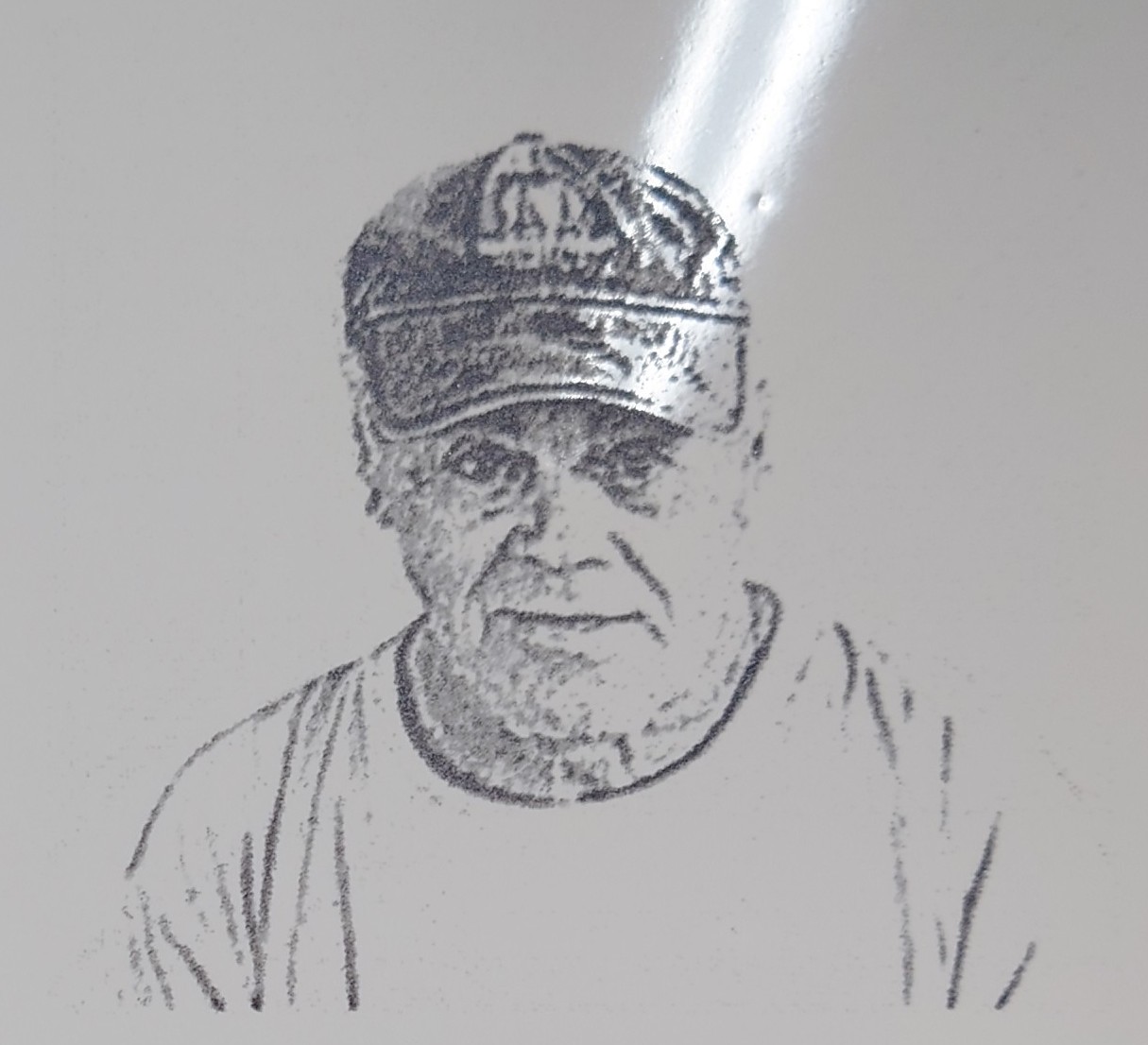

Great to hear you got it Kate. I’ve never had a laser before but I’m impressed with what they can do my first real project was laser engraving a ceramic tile with a portrait of my dad using the Norton white tile method and after adjusting the speed three times It came out decent.
Wow, that is really cool! I’ll have to look that method up and try it out!
