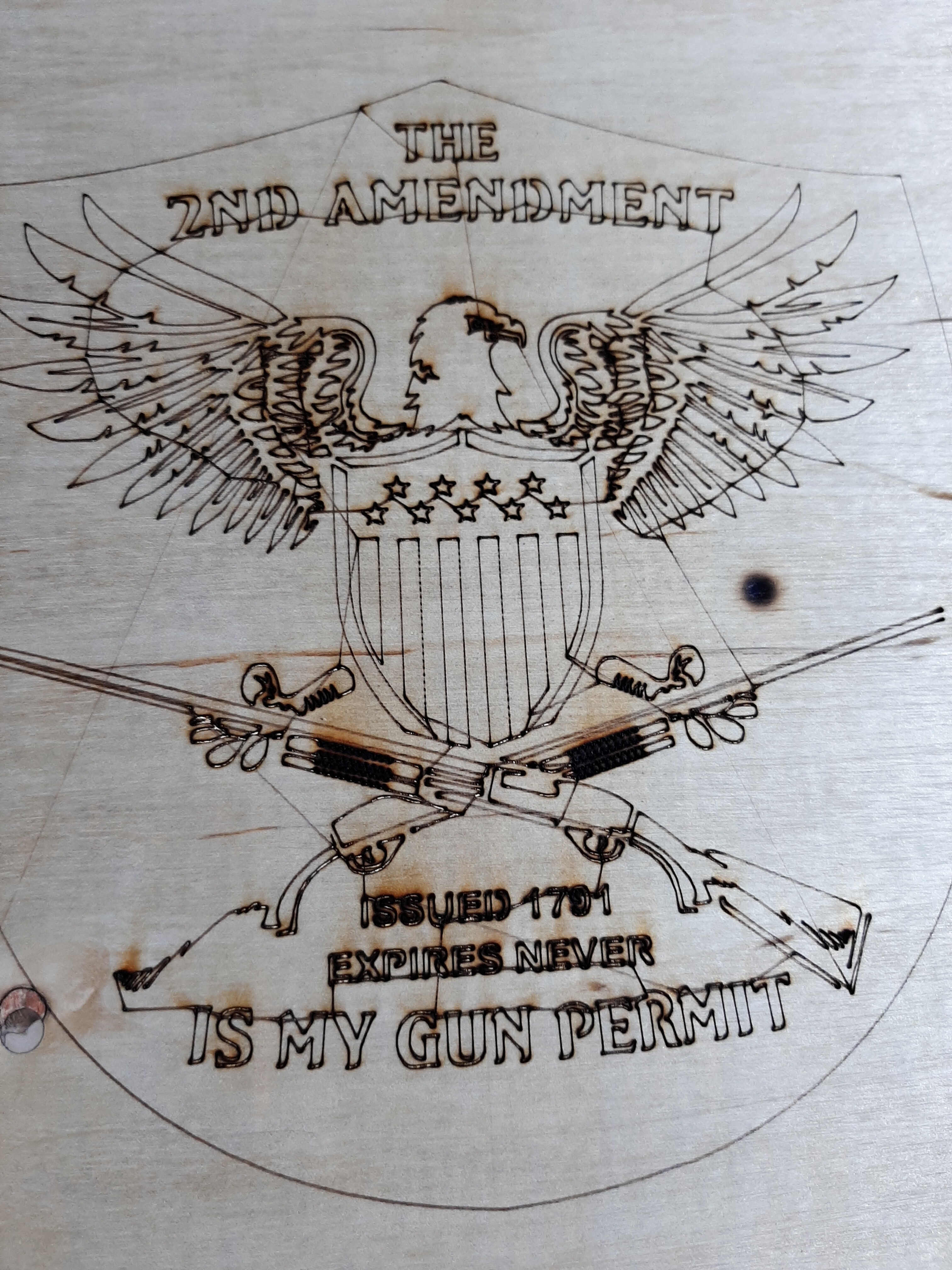

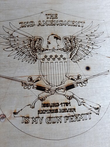

What laser or controller should I pick in Lightburn for the j tech 7 W laser ? I tryed GRBL and after making the g code the laser will not turn on . If I push the reset the laser comes on at full power and stays on and makes burn trails as to where the laser cuts . Anyone know what I’m doing wrong?

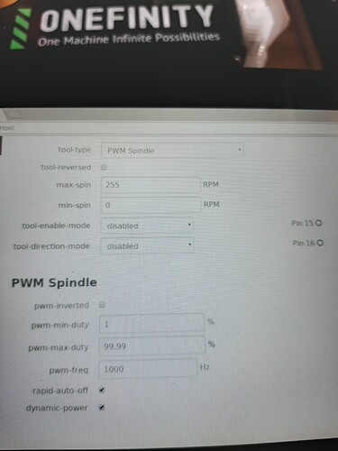

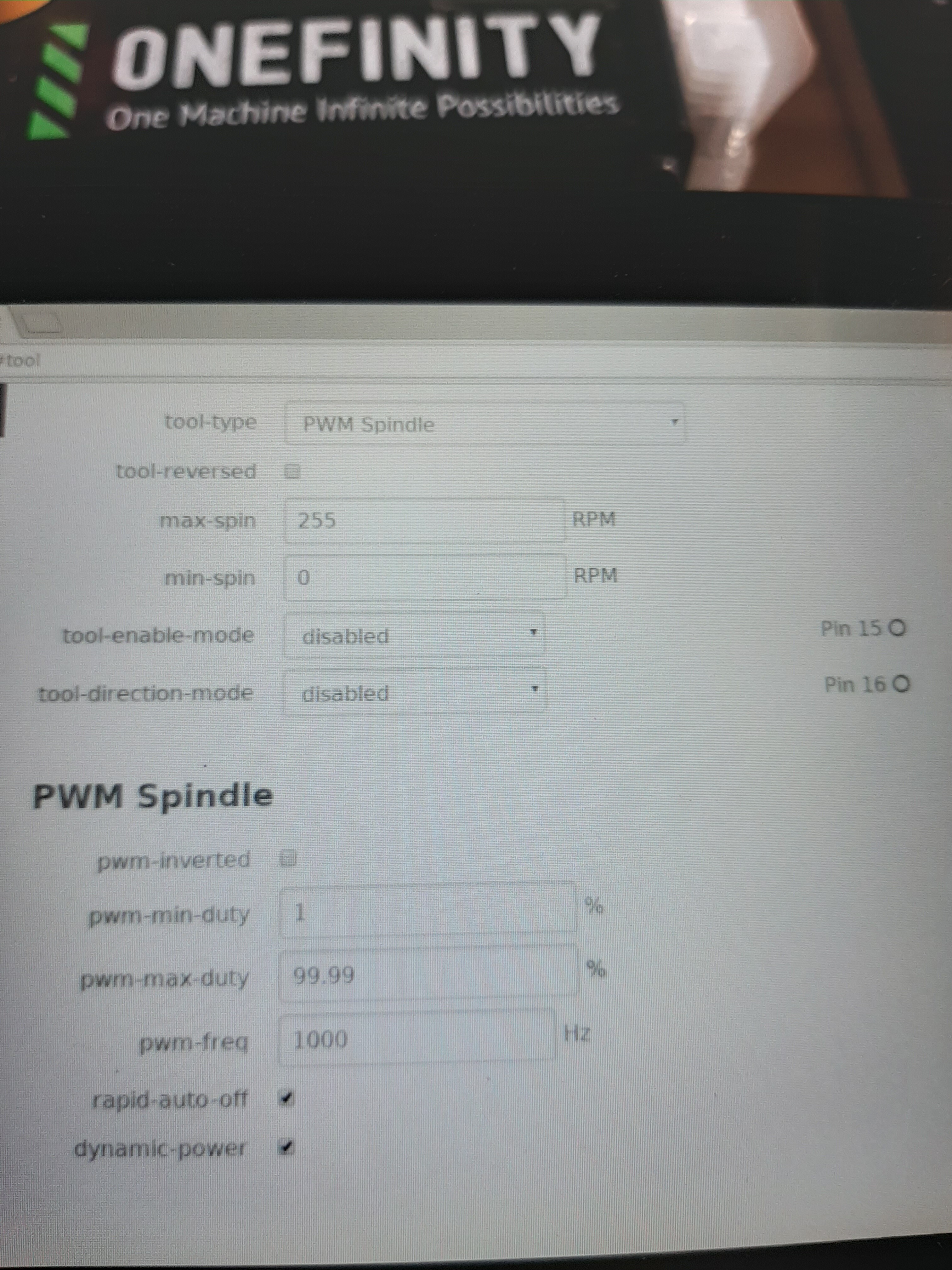

On the OF interface, you have to go to Tool and select the PWM spindle, and ensure the bottom two checkboxes are checked.
Scott , did the changes and still the laser won’t turn on I have to push the reset and the go on the controller at the same time and still get the laser travel lines . I thank youfor any other suggestions I’m still new to all of this but trying.
I am not sure but did you save that setting change???
Yep I saved the setting. I’m thinking I’m doing something in lightburn that isn’t correct
