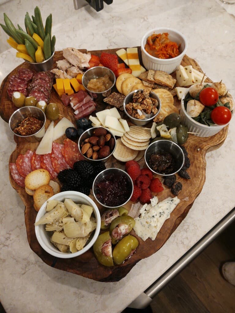

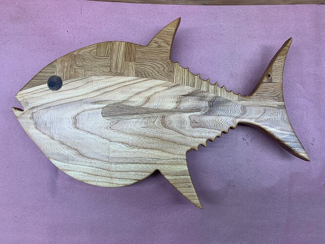

My latest charcutery board - hickory upper - white oak lower - poplar/black walnut eye

Nom Nom
you have made the meat and vegetables look so realistic :smile:

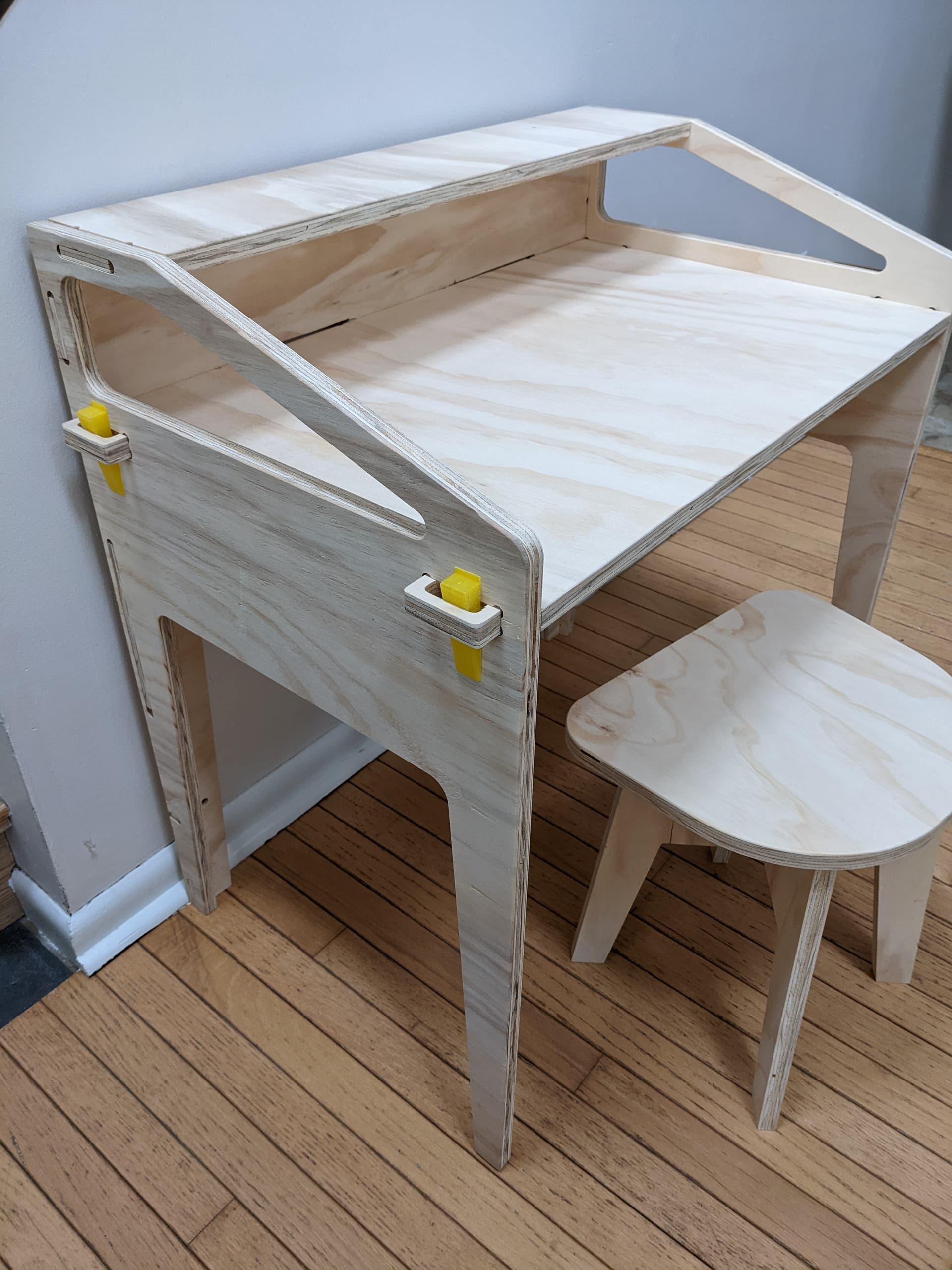

Flat pack desk & chair from 1 sheet of ply for kids who need a desk for remote school or whatever and can’t afford one.
This was the first one. I’ve tightened up the desk surface to back joint and created a version that fits older teenagers. It takes a JM sized machine because I set it up to cut out of 3 48x32" slices of a plywood sheet.
Looks effective.
Ive put some plywoid together, nothing quite so elegant, in a related. I had trouble with side racking. Is the back upright piece holding it rigid?
The panels all lock together pretty tight - takes a smack with a rubber mallet to get the tabs into the slots. You can see a couple of the tabs/slots in the upper left.
The wedged slots give it a lot of rigidity because you can tap the wedges in very tightly. Those are tile leveling wedges.
The legs become a triangle of support because one hooks into the other at the bottom and about a qtr up from the floor there’s a hole & groove that a ziptie ties the legs together. There’s also a tab on the back leg that fits into a slot on the side leg that’s about 12" long.
It’s all from a design from the Baltimore Makerspace that I modded a little and upsized for taller/older kids. This one is about 28" to the desk surface.
Very nice! I like the design.
Do the wedged slots suffice to hold it stable or did you glue it? A writing surface is demanding.
No glue. The wedges are tight (& there’s still more they could be tapped in if necessary).

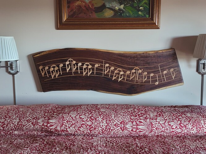

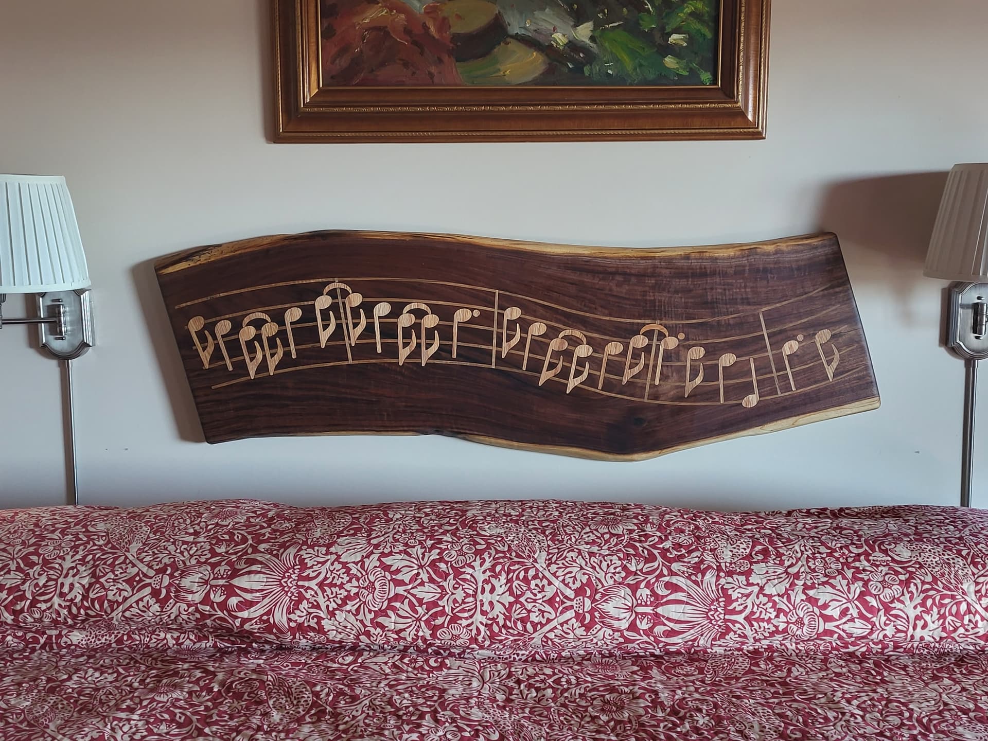

We needed a headboard for the MB so I thought I’d do some inlay and tile work for this project. The slab is 57" long and heavy which made the whole process a bit more involved than I had envisioned. The staff line inlays are spalted wormy maple while the notes are white oak. Everything was done with the 1F including the pilot locators for the MDF sled used to qualify the tile locations. Lines and notes were created solely with Vcarve Pro. I photographed the slab and processed it in CS5 then traced the bitmap. (some foam carve tests helped too)
Is anyone up to identifying the song this measure is from? (a hint: It’s by a group I saw live on stage in Cincinnati during their 1966 US tour)

i wanna be your man?
No, but pretty close (band wise). I’ll give it up since it has been so long:
–I’m only sleeping–

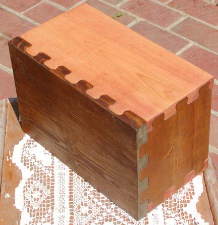

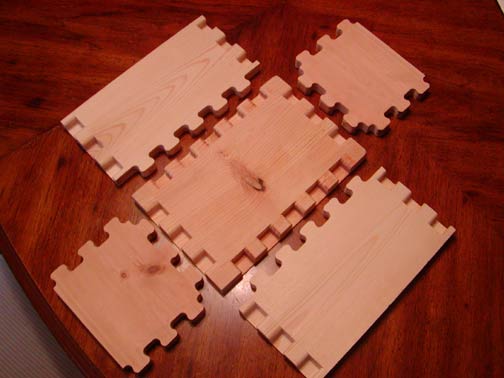

First post here.
Made this box long time ago on my first cnc. Waiting on my 1F just ordered
boxboards413
boxbottom415

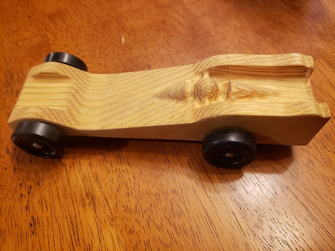

And a Pinewood Derby car

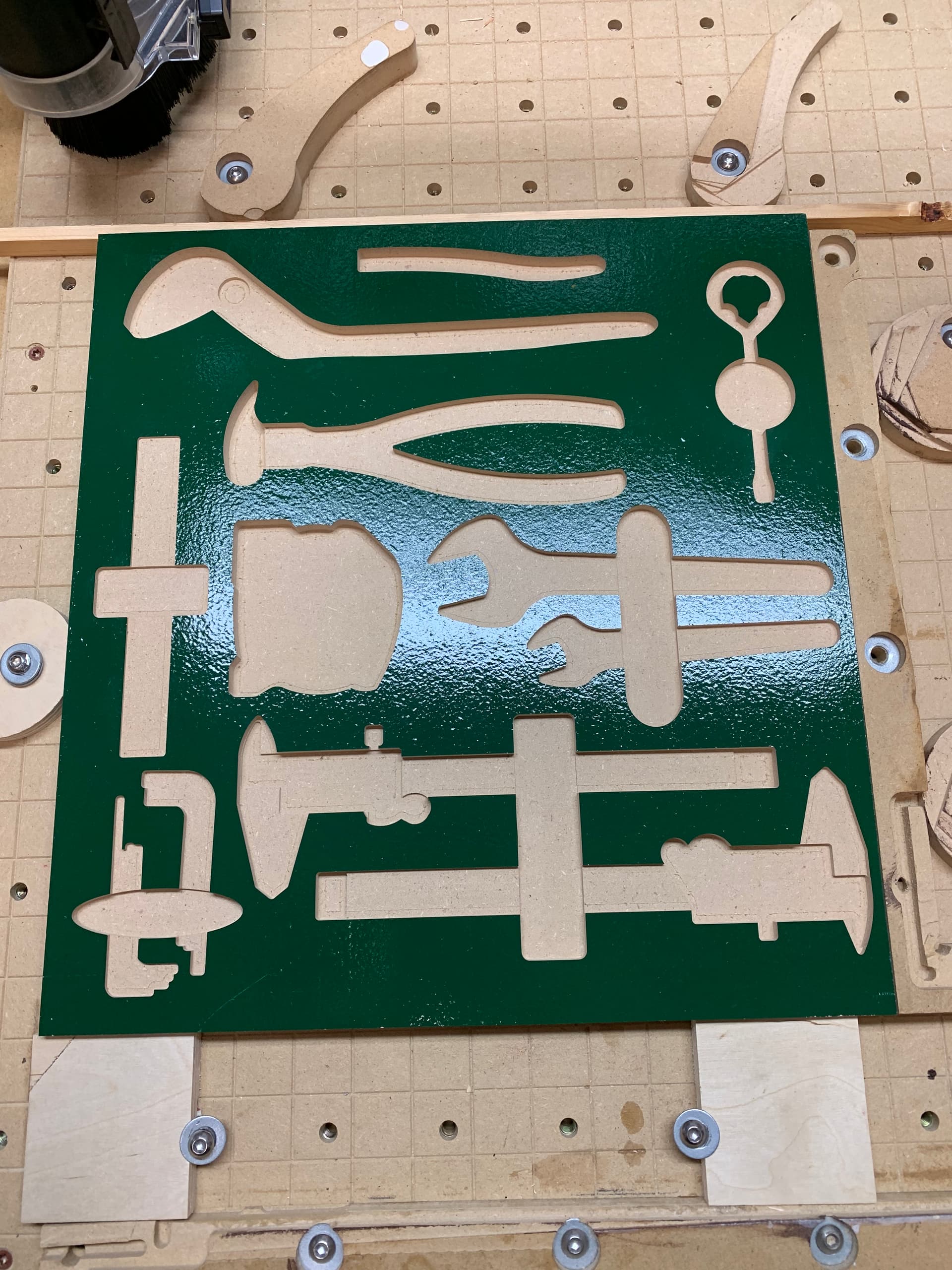

In an effort to get organized and stop wandering around looking for that thing I just had a minute ago….
Those profiles are spot on! how did you digitize them so well? I have tried various routes, but they are either to tedious or the result is poor.
First I traced the tool on a sheet of paper, then I scanned it as a JPEG. I then imported the jpegs into vetric. I did have to spend a little time cleaning up the images in vetric. I also ran a few practice cuts to make sure I got some of the depths correct. It was a time consuming process, but I learned a lot about vetric and my machine while doing this. Next up will be something for bits.
