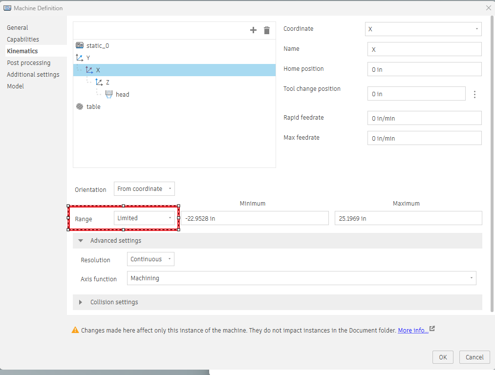

If you receive an out of bounds error when you run a program after doing this, it’s likely caused by some of the nuances of the machine setup. Go back to the “Machine Library”, then “Kinematics”, then try adjusting the range to “Unlimited” on the the Y, X, and Z axis. I’ve never had to do this, but if the “minimum” and “maximum” values shown aren’t right, the machine might throw a soft alarm during the program.
