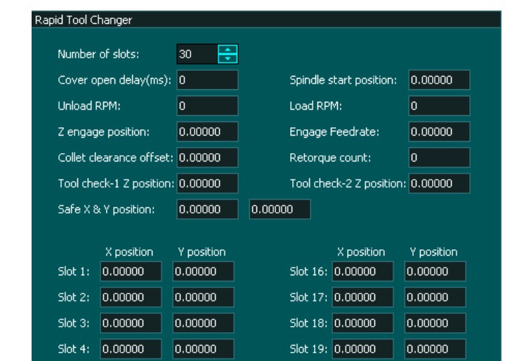

I’m getting around to setting up the RC ATC and thought I remember seeing a post showing the settings for the native TC setup but can’t seem to find it. Can’t find what I’m looking for in either the Masso doc or on the RC site. Can someone tell me what settings i should be using on the Masso. The RC site did mention 1500RPM for 2.2kw, is that for load and unload? think I seen somewhere a feed of 78.7ipm.
Thanks
-JR
Mitchel woodworks has a detailed complete set up for the rc ATC go online and follow step by step you will not regret it.
