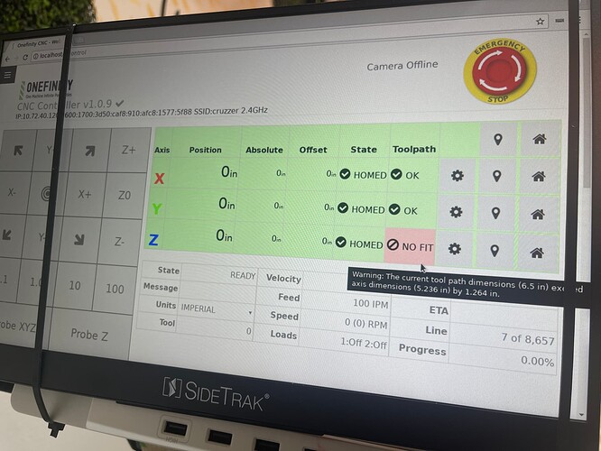

Hi! Im new to CNC and I’m getting this error for the past 2 days, I don’t know how to fix it, did someone had this problem and knows how to fix it? Please help ![]()
We are going to need a little more detail. What software are you using? What are you trying to do? It says your gcode is calling 6.5 inches of travel. That is more than the machine can do.
