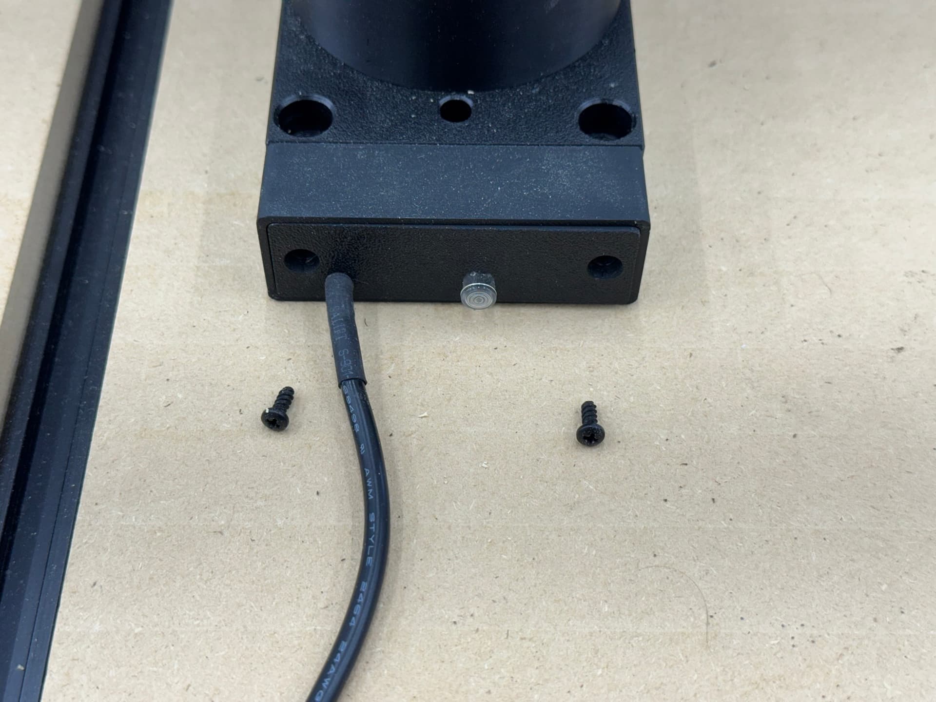

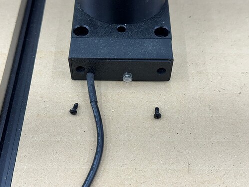

  2. On one of the ATCs, we will be removing the wire and cover from the left side (when logo is facing you).
  3. Remove the two small Phillips screws.
  4. Pull cover off, exposing the circuit board inside
