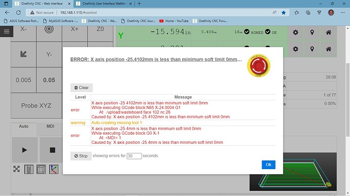

what does it mean?
The X axis start position is beyond the machine limits (established as ‘home position’)…too far to the left in this case.
Try moving the start position the indicated (+)25.4102mm to the right and the error should go away.
