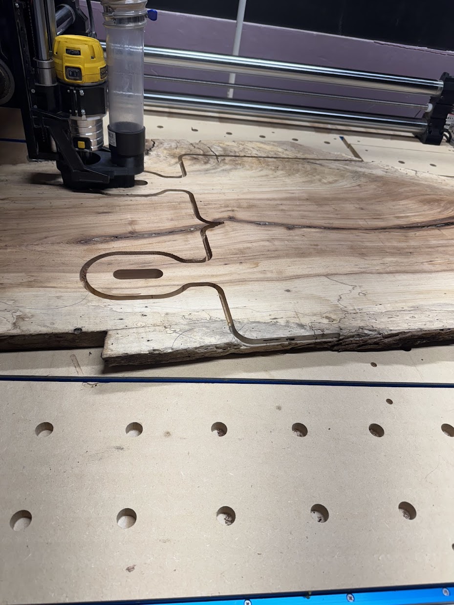

Hey, so I have been doing something similar to this. I picked up this probe a month ago. I’m also running the newest firmware on the masso. I haven’t had any issues so far. Calibrating the probe when you have a tool setter can be a pain. I’m using the probing function on the masso; The new firmware adds an option to save the probe data to a file. The file has the X,Y, and Z coordinates and a description of the probing direction (TOP, LEFTSIDE, etc)
Right now, I’m using a Python script to convert it to a DXF so I get a 2d view in Fusion360. You can use Meshmixer to convert it to a surface map.

I have been working on locally sourced irregularly shaped slabs and fitting a design to the wood works for me. Now you are going to have to forgive me if I don’t know all the correct machining or woodworking terms. I’m a simple programmer and gamer, and I’m not up to speed on all the terminology for my hobby.
The customer wanted some large charcutery boards cut out of this piece of lumber, and the main requirement was that the finished products needed to use the crotch and fit together.
Yes, I could have put a vBit in my router, and I could have moved it over each point and written it down. Then, I manually entered each point into my CAD package, made the polygon, and designed the shape. I did this on my first few projects, and it takes a lot of hours. With the probe, it took 30 minutes from when the slab was secured to when it was in F360.
