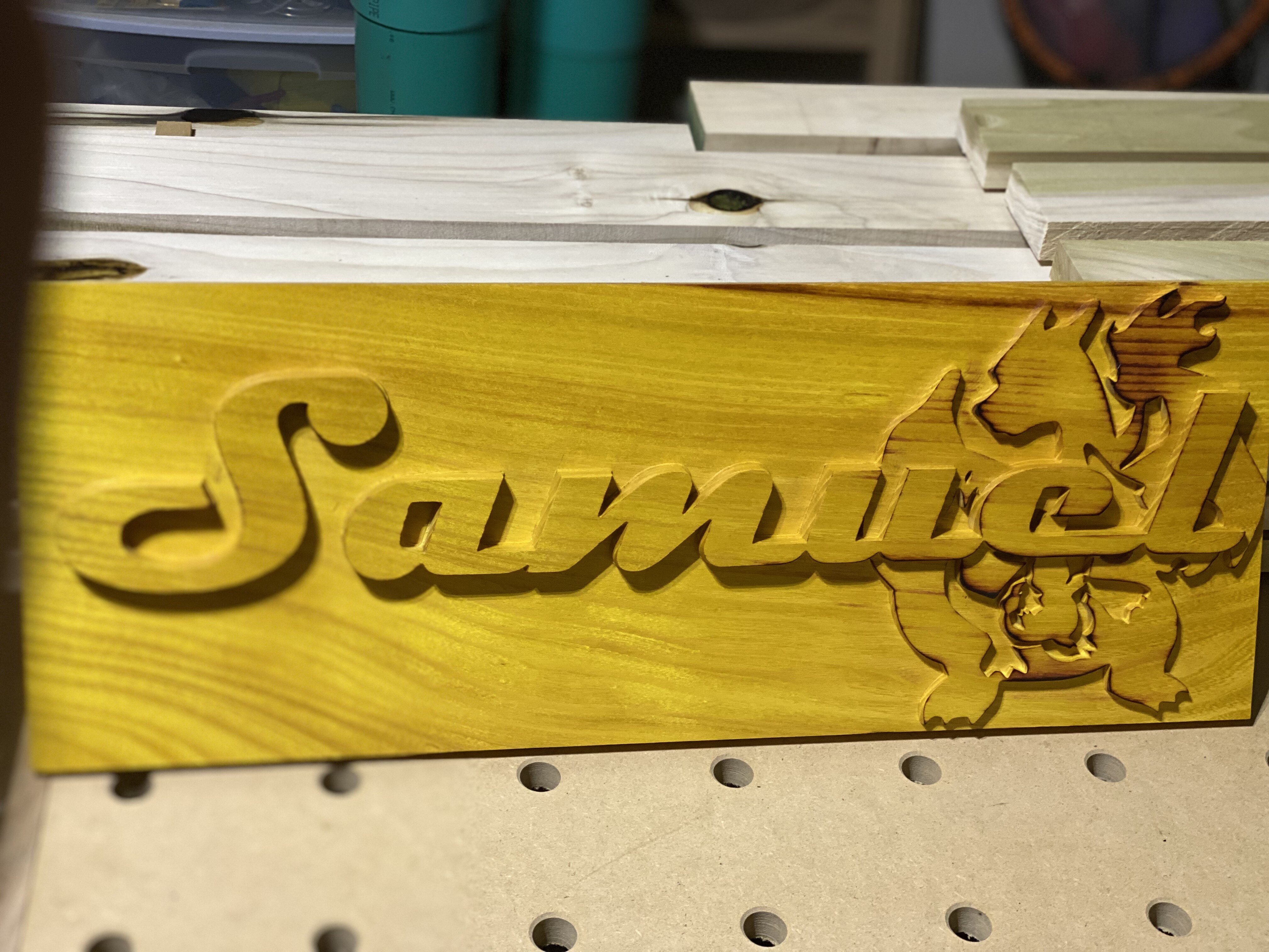

Jarod - is that carved with a straight bit (not a v-bit)? What you’ve done looks great - but I think we’re all scratching our heads trying to figure out how to do this (in Fusion 360) with a combination of a v-bit for tapered verticals and a spiral endmill for the roughing pass.

This was my practice one so it was all done with a spiral downcut bit.
The one I just posted was a mix of a spiral downcut bit and a v-bit
Basically the way to do it in fusion is to create a 2D pocket toolpath for the larger areas that need to be cleared out. Then you come back and use the trace engrave toolpath for your v-bit and it will go along the lines of the piece to create the tapered walls.
This was all done with a straight bit. In order to do it with a v-bit I would check the stock to leave box and leave a certain amount of stock and then come back and use rest machining with a v-bit to carve away the remaining stock left by the end mill.
