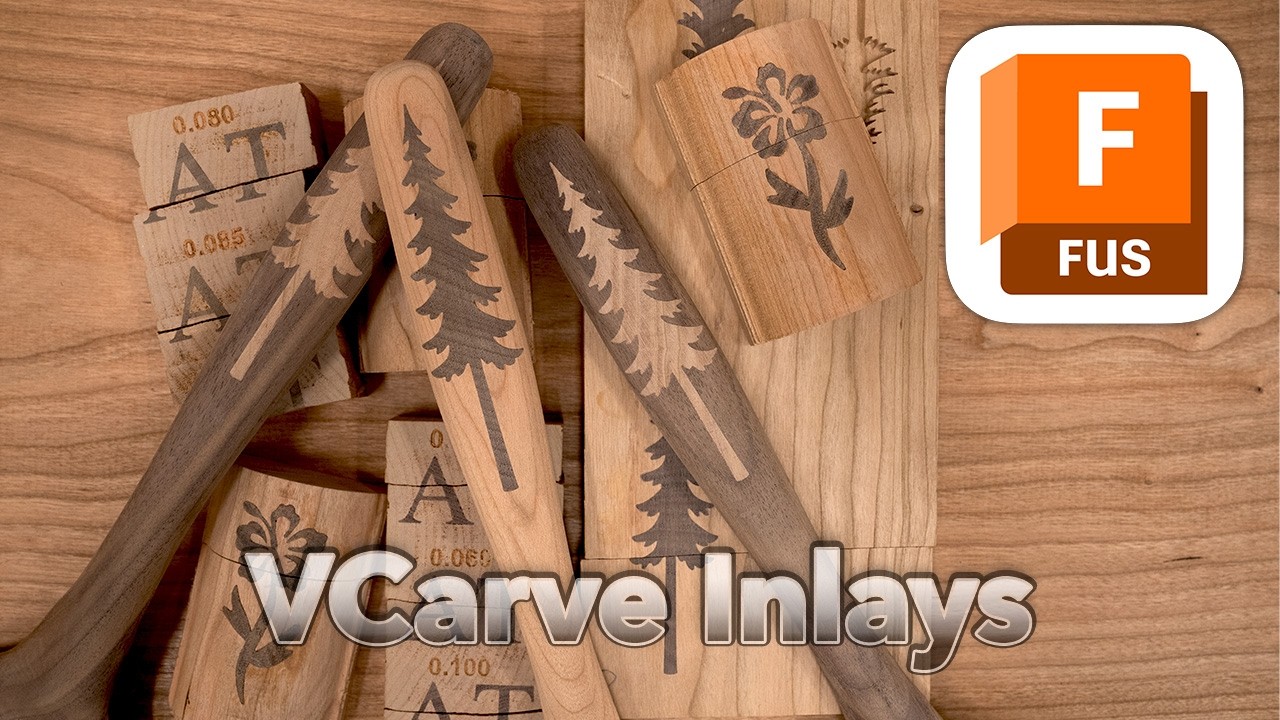

Hi everyone! I also have been working on V-carve inlays with Fusion 360. Both flat 2D inlays, and curved surface 3D inlays.
I wrote a plugin to automate the process. I can’t post the link (new user limits).
Here’s a video walking through using it and finding the perfect fit:
Corbin
I’ve been following Corbin for a while, and he does some really good CNC stuff. Here’s the link to his plug-in.
https://www.corbinsworkshop.com/shop/vcarve-inlay-plugin-for-autodesk-fusion-360/
Thanks for making this plugin. Fusion has been needing this for a while. I’m going to download it and give it a try this week.
Thanks @BuckeyeDennis for posting the link!
@Davidf01 Definitely give it a try and let me know what you think! I took a different approach than what chips did by using 3d Toolpaths even for 2D/flat operations. But the great part of doing this is it easily extends to 3d designs and inlays.
