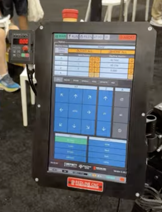

One more thing. Where are the DRO mounting screws? The Redline controller video shows the DRO mounted at the top left (from the front - top right on the back).
Here is a screen shot of the DRO mounted (taken from a Youtube video)
Check the manual :slight_smile:
They are in your vfd

One more gotcha for VFD noobs: the button on the side of the Manual VFD control unit, toggles between manual mode ON/OFF. When this is mounted to your Redlind controller, that button is located at the SIDE, and not actually visible from the front. When pressed in (meaning manual mode), your gcode will be stuck in “Spindle Wait” mode.
