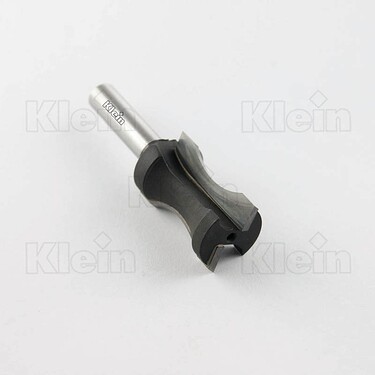

Does anyone happen to know a router bit that I can use to mill a flat edge on my 500 mm diameter round plate which is 27 mm thick?
I can’t find a corresponding cutter for the router… below I have tried to draw the whole thing… hope it is understandable. :slight_smile:
Thanks for any tips. :slight_smile:

Regarding router bits, couldn’t this one match?
HW CONVEX EDGING BITS Z2 – Sistemi Klein
By the way, what is the radius of your round edge?
I try to make a flat rounded edge. So not nice round. Thickness is 27 mm.
I think the one from Aiph5u could work. It just would need a ball bearing.

The radius of the Sistemi Klein convex router bit is 18 mm so a circle with 36 mm diameter (d). Seems to match:
I hope I was allowed to draw my circle on your drawing!
But I would do it with the 8 mm radius cutter (ball nose) as shown above in the video. Especially because the 8 mm radius cutter costs only half the price of the convex router bit and a radius cutter is versatile and can be used on many, many other projects!
