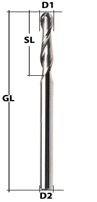

If you have a CNC, why don’t you replace sanding by slowly milling with a 8 mm radius cutter. You can get finishes that require no sanding after this (if you take time) like in in this example. Leaves a smooth finish when using a 8 mm radius cutter as last pass, 0.4 mm stepover.
Sorotec Shop » Cutting Tools » Sorotec tools » Radius
Mill Z2 Ø 8 mm UNI
