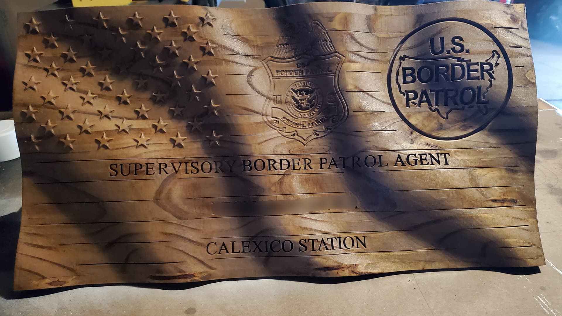

I don’t recall ever doing much sanding on any of my 3d stuff. Mostly brass brush and that’s it. It always amazes me how little work I have to do after a 3d carve. That’s fo me atleast. Last one was 3 weeks ago a wavy flag and was smooth as butter.

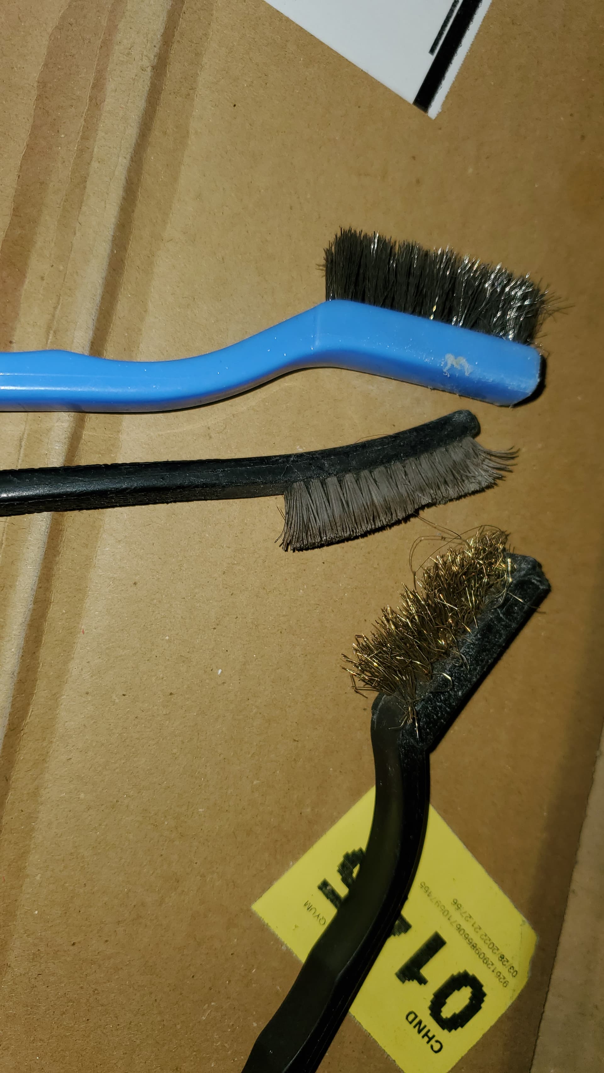

Cesar - those look terrific! Is this the kind of brush you’re using? I use water-based spray lacquer and whether or not I use a mist of water to pre-raise the grain, the first coat of lacquer raises nibs that need to be cleared before the the 2nd and third coat go on. https://smile.amazon.com/gp/product/B004FTPXWC/ref=ppx_yo_dt_b_asin_image_o00_s00?ie=UTF8&psc=1
Jim - that should work, but these might give you some more options: https://amzn.to/3Kxae5S
Various sizes and compositions - I like the nylon one since it’s less abrasive, but the steel and brass ones remove more material.
These are what I use. Usually the brass does the work. If it’s thinner more delicate stuff I’ll use the Nylon one. I picked these up cheap at Harbor Freight. I use shellac since most of these are going indoors and on a wall. After the first coat, I can usually knock any raised fibers off with running my hand over them or a vacuum brush attachment.
