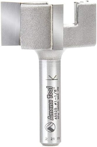

I wanted to upgrade to something that could take a 1/2" bit as I use the CNC for flatten boards. I ran it today with some walnut and it worked beautifully. I was a little surprised and easy the upgrade was.

Spoilboard Bit
