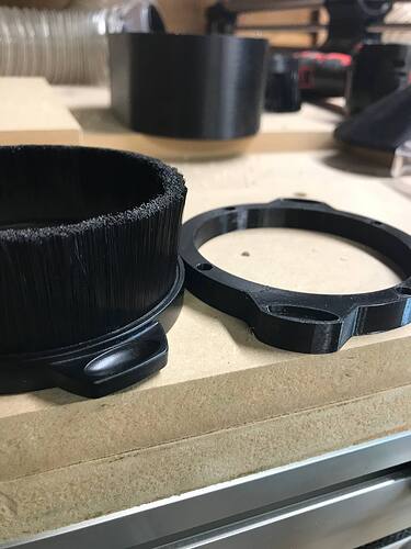

@Captain @HardtailSr I can make the handles “thinner” more to match what the SM boot comes with and I could make a gap in the ring so its not a solid circle. Otherwise this ring fits perfectly. The magnet holes are based on some 5mmx4mm ones I had which are the same diameter it seems that the original brush rings come with. The holes are sized for a tight and glue free friction fit.

Thanks for looking into it Calvin! Pretty cool to see that it works. I’d like to see if Onefinity will offer the whole assembly for sale, but if not, I’ll hit you up when mine gets hurt. Did you order a new brush? I’m guessing that if this shoe gets bumped off the machine, the brush will get damaged too.
Hey Calvin I only need the hose adapter at the moment.
If this turns into something that folks actually want Ill probably order some of the brushes off McMaster Carr which should fit in that same slot. I have been working on making my own dust shoe entirely so I have some other brushes laying around for that.
If you’re looking at any potential design enhancements, I think angling the brush outwards would be really nice. Not sure how the brush rail would handle any twist like that, but I’m seeing that on the longer brush, the bristles are starting to angle inwards at the bottom towards the bit due to the vacuum pressure. Not a huge deal but I’ve had a similar shoe before and once the bristles angle more inward, they start to clog up the intake area and can really obstruct flow. I think angling the brushes outward (maybe 15 to 20 degrees) would help quite a bit. There’s not much space between the back of the spindle and the z carriage, so there’s not much room to angle there though unfortunately.
Thats very easy to do. I noticed with the brushes Onefinity sent if you install them one way they are straight down and if you flip them around it angles out naturally. Hard to explain but I would try pulling your brush out and whichever side was facing in make it face outward. As far as my ring I can make whatever changes folks want no biggie.
