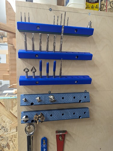

I use a system similar to this:
  • 1-9 - 1/16” bits
  • 10-19 - 1/8” Bits
  • 20-29 - 1/4” Spiral Bits
  • 30-39 - 1/4” Engraving Bits
  • 40-49 - 1/4” Profile Bits (Bowl, etc.)
  • 50-59 - 1/4” Facing Bits
This matches my tool library in Fusion, so I can easily get the right tool looking at the program.
I just finished printing the wall holders (Makerworld), I’ll be adding labels to ease identification.
