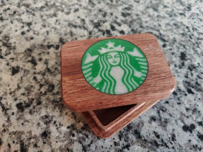

@760woodworking Thanks for the Explanation, I will spend some time re reading that but I think I’m getting the gist of it. I was finishing up an Epoxy thing and I used SailorMike’s suggestion in putting in the pauses, I looked at the gcode and quickly figured out where to insert the M0 breaks and it worked excellent! Though I want to learn all the things about it as i figure it will give me a more precise grasp on things in future projects.
I used that method on this simple little gift card box I built for a friend who is obsessed with Starbucks coffee
