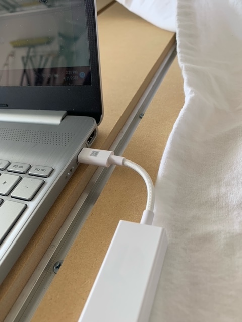

Here’s what I see.
Hey Phillip,
your USB-to-Ethernet Host Adapter on your laptop seems to have the address 169.254.3.214, but I see no other address on this subnet except the 169.254.255.255 entry.
You seem to have a 10.x.x.x private network now. What is 10.0.0.243?

Can you try entering the command “ping 169.254.255.255” without the quotes then run the “arp -a” command again. This may force the controller to show itself on the network.
I have no idea. You can see what I have hooked up.
Hey Phillip,
try the ping command Derek suggested. The fact that you have a 169.254.x.x. range address assigned to your Ethernet Adapter means there is something configured with link-local at the other end (that has an IP address too)
image0.jpegThis is what I get with Wi-Fi on or off
Try arp -a again after ping 169.254.255.255 to see if it populated a dynamic entry in the arp table.
