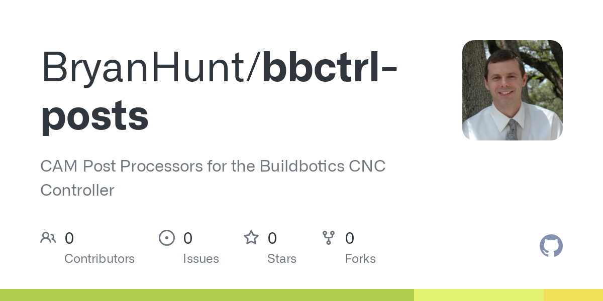

If you are using the Buildbotics post with Fusion 360 and a spindle, I have updated it to add a delay after setting the spindle speed. You can get the update here to try it out:
You will find a Spindle Delay property that you can set in seconds.
