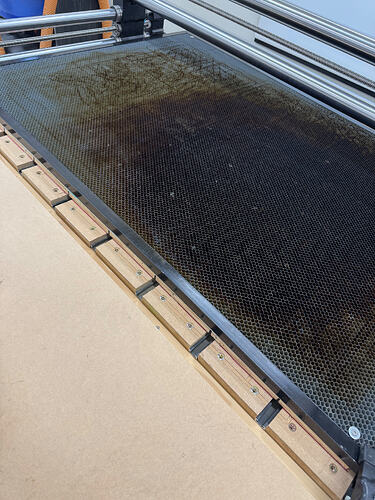

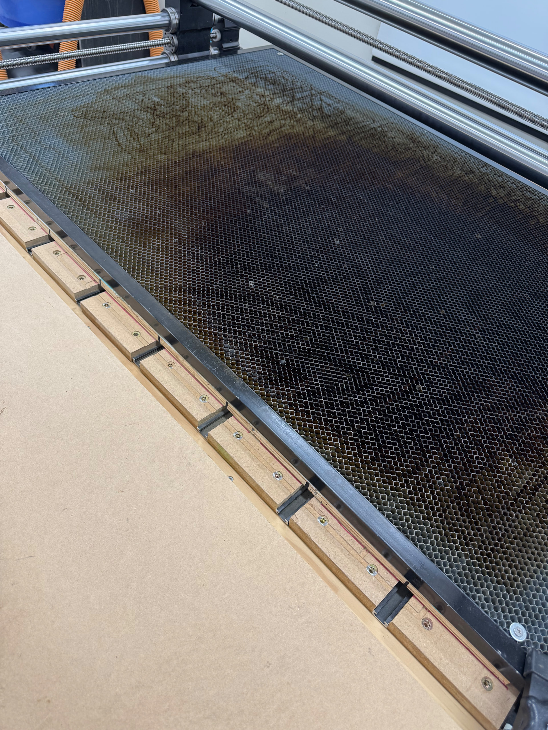

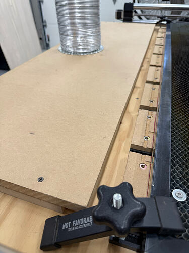

We used the T channels from our router waste board as suction channels that feed duct work connected to a 8” AC Infinity fan. Then vented outside. Sucks the smoke from beneath. Then attached a dust collector to the front of the laser in case any fumes vented above.

Just one simple question, the honeycomb comes with a thin metal beneath to protect the wasteboard. If using the T channels for suction do you have to remove the metal sheet? Any burning occurring to the Wasteboard?
Thanks Bill
My honeycomb board sits on a thin piece of sheet metal that is screwed into a quarter inch plywood. When putting this all together, I removed the honeycomb and drilled a quarter inch hole through the sheet metal and the plywood every 2 inches for each T channel. I just needed to make sure that those holes were in line with the T channels that are sandwiched between the strips of waste board that is used for my router.
The in-line fan was important. It needed to be strong enough to pull enough air through all of those quarter inch holes. I highly recommend the 8 inch AC Infinity fan, which can be found on Amazon. Anything less, I fear, would not pull enough CFMs.

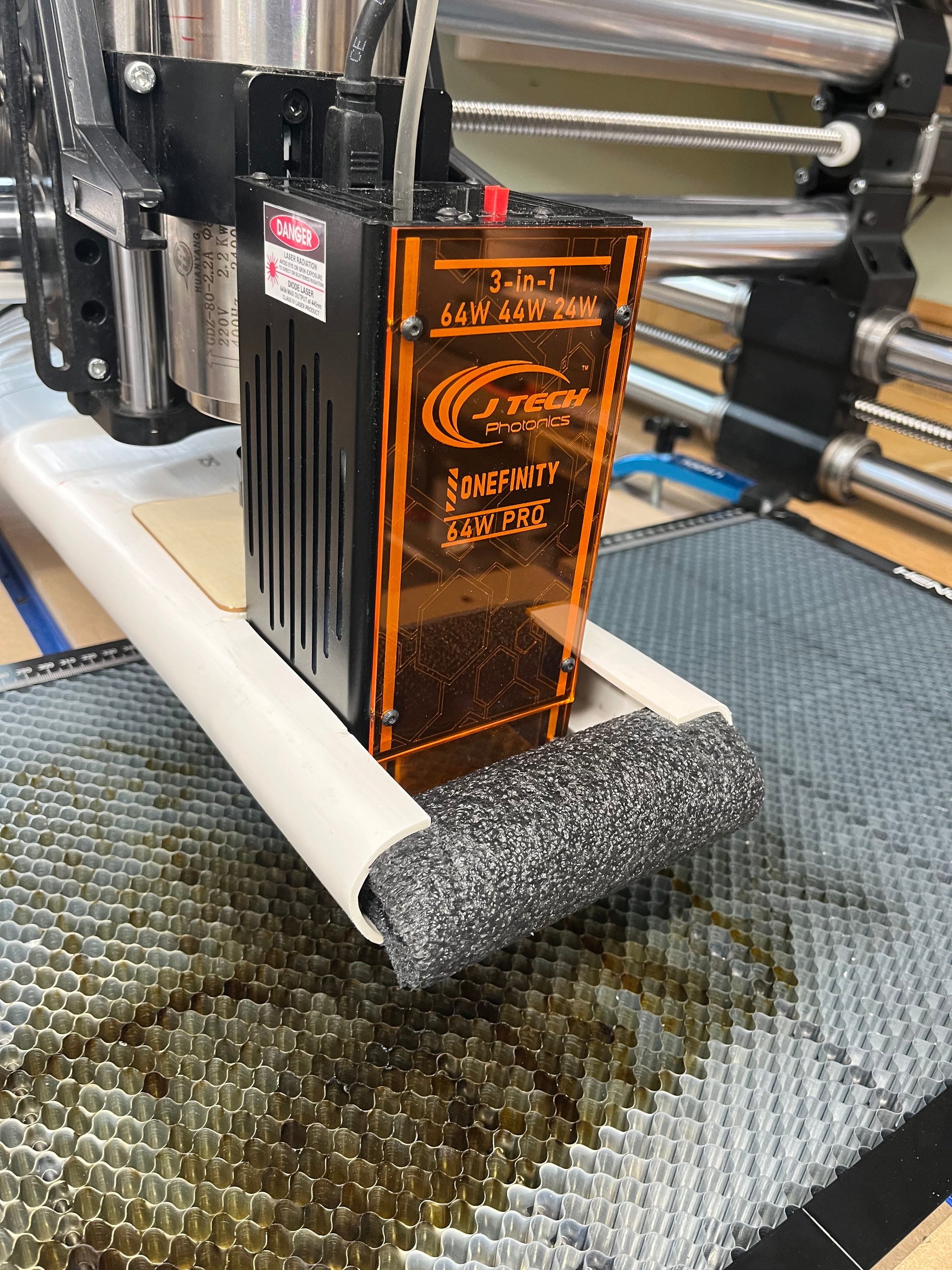

I was hesitant to post this, but it seems to work relatively well. I like the creativity of both Tom C and DrSys’s approach to fume removal. Call mine the Jerry-rigged version involving sewer pipe, a heat gun, rubber mallet, and 1” spacer board.
Heated woodworking shop – attached to unheated garage
Midwest winter climate
Onefinity Woodworker
64W J Tech Laser with air supply from a compressor w/Filter regulator, water separator
Lucky to have a double-hung window close behind the CNC
The 64W is a 3.25” boxy laser and the challenge was to find or make something big enough to surround it. A spider farmer 4” is used to draw fumes (see Tom’s recommendation). With my air compressor in the adjoining attached garage, the air blowing through the laser is from outside the heated workshop; compressed air (being well above freezing) is being sucked out with the fumes. Thus, in theory, I’m keeping my heated shop air….or so I like to think?
The suction pipe is held in place using a bolt and the spindle collet. The spindle/router may have to be adjusted up or down within the clamp for the just-right setting. Hope photos will clarify everything.
Caution! Is easy to raise Z and ram the pipe into the Z slider frame.
HIGHLY RECOMMED Using a “no Z” post processor”
