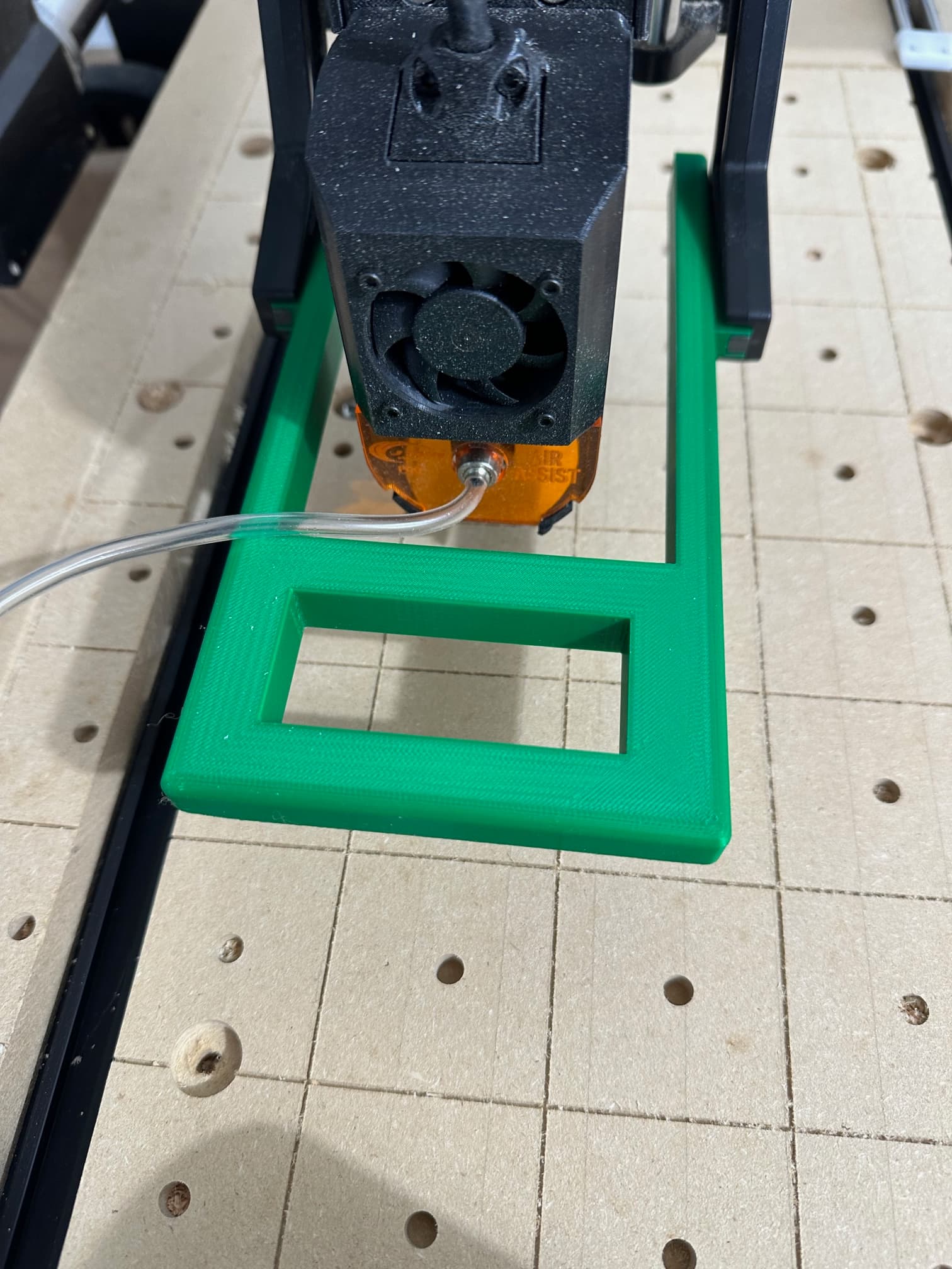

I ended up designing and 3D printing a bracket and a 4" hose adaptor.
Oooo, that’s nice.:nerd_face: Adding a few extra characters here to make up for my brevity.
nice, would you mind sharing the design file? Id love to tinker around and tweak that for my setup. I like that it uses the suckit arms as well.
Hi @makermatt ,
Here is the design file (Fusion 360).
Please share back if you have interesting tweaks.
LaserFumeAdaptor v15.f3d (236.3 KB)
