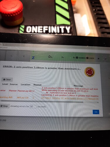

After creating a g code in Carbin Create i get e stop and messages in the pictures im adding. Any one know what I’m doing wrong and how to fix it?
I can run a file that was made in light burn if I turn the router on but the router will not lift up or down ??

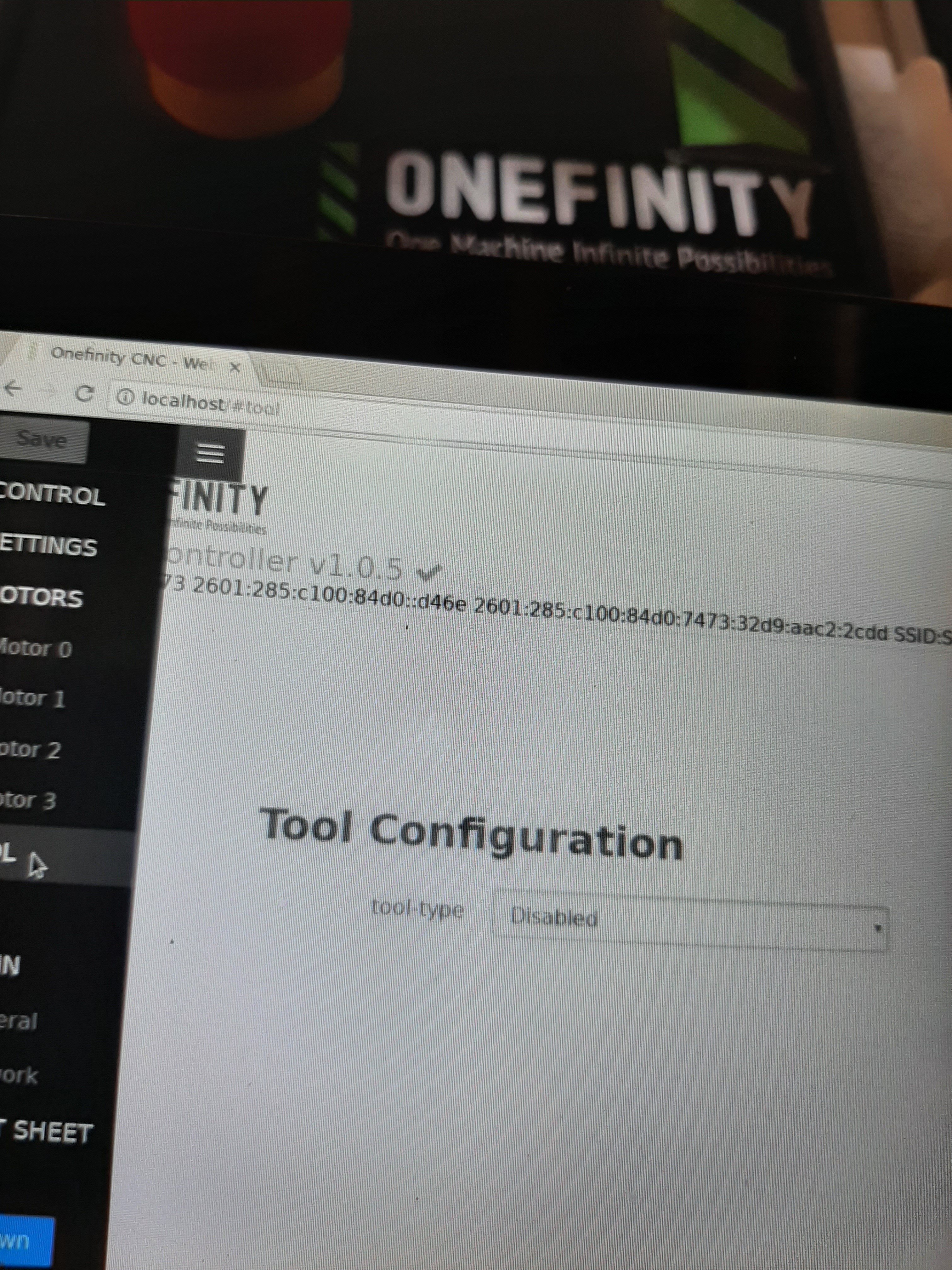

Under tool configuration change tool type from PWM spindle to none.
Tried that but still gives me errors as in the pics. I’m lost as to what to do . 20210201_163835|375x500
It’s the opposite of enabling the laser.
Under tool (not i/o configuration), select disabled:
Make SURE to hit save in the upper left fly out menu after you make the change. That is all that is required to go from laser to cnc, changing the tool-type under the tool flyout settings.
Still not working see pics .20210201_182631|375x500

It looks as if that did the trick.
I thank you so much for the excellent advice and sticking with this new CNC guy.under the o/i i had e stop set to normally closed, i changed it to normally opened and hit play and it started cutting.
