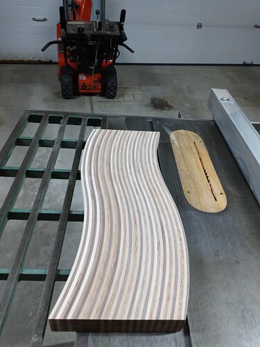

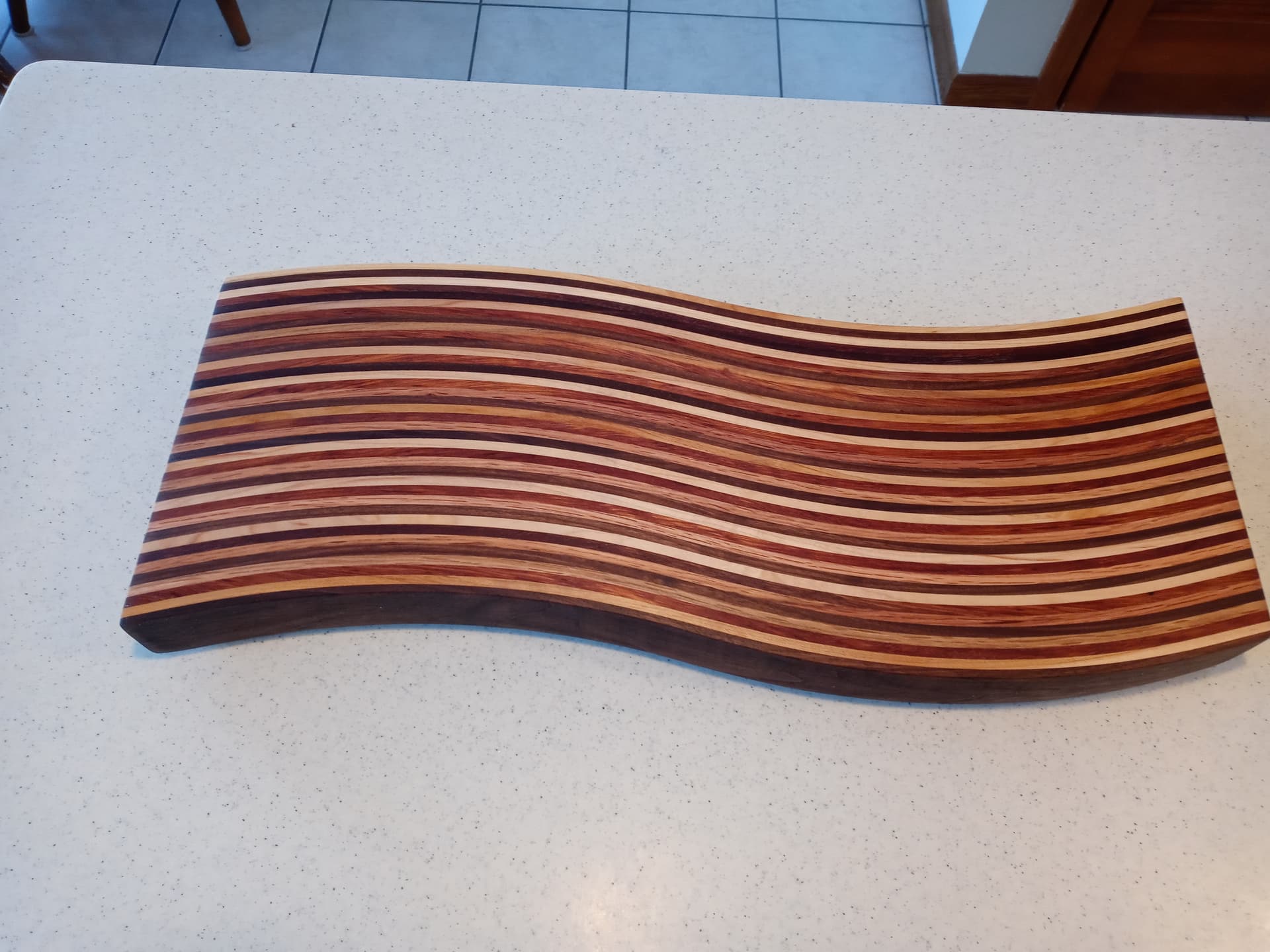

any help on where to start this using carveco. I want to cut wavy strips 1/4 thick 20in long. picture a straight line 20in long. curves down 1/2 in to the 5in mark, back up through center at 10 in up 1/2 to 15in and back down to 20 in a smooth continous curve. anyn help where to start woud be great. i now cut strips on ts and bend in a form
