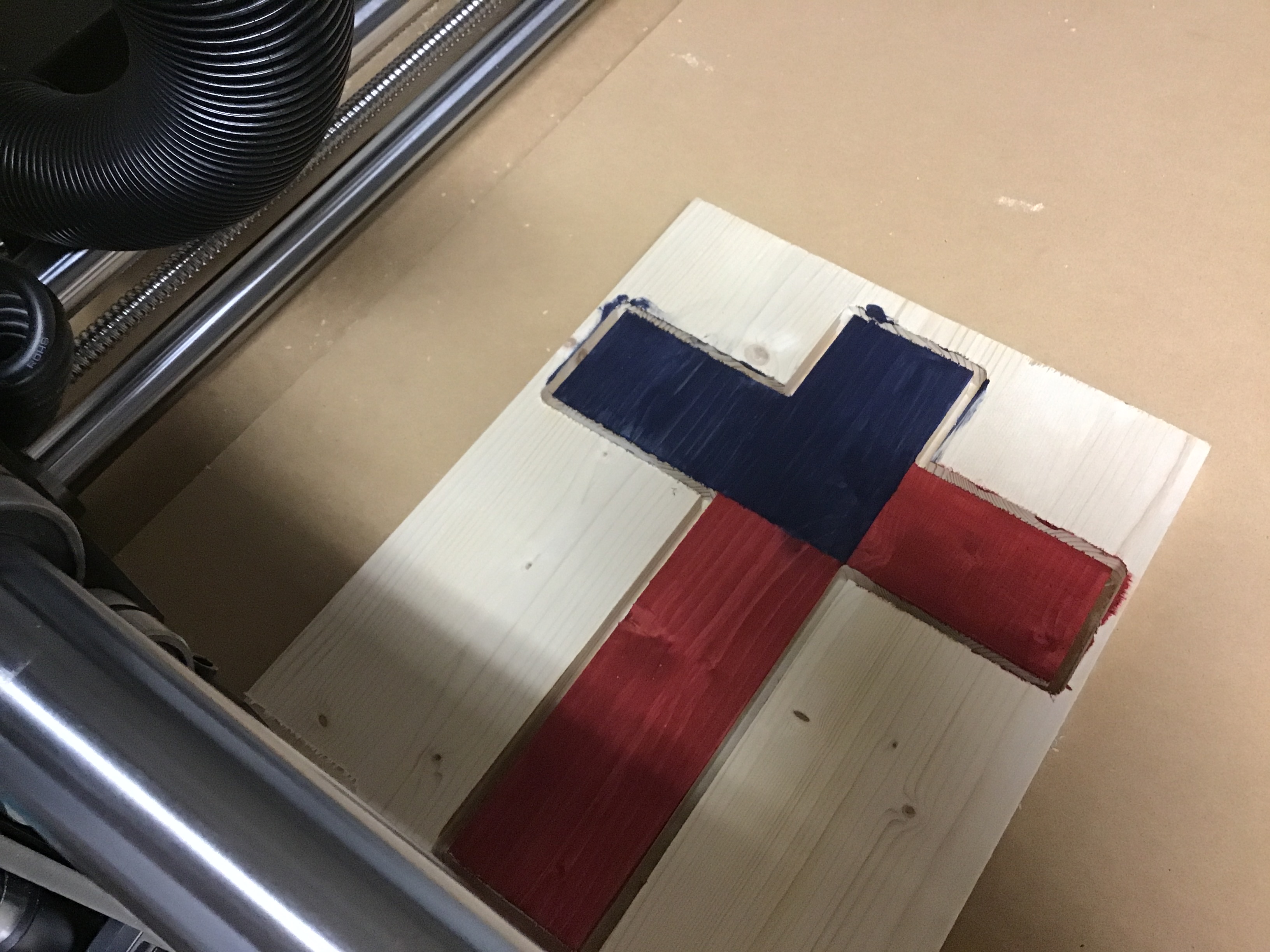

I am getting a Y axis error code when I try to load any program…I have the datum set in the lower corner, I did get my outline to cut somehow, but have been unable to get anything else to run. Newbie here and getting very frustrated. Have read similar posts and have tried everything they suggested and still have been unable to do anything more than the outline.
I am trying to get the Stars and Stripes to cut

Thanks, my point of origin matched in both, I just had my wood to close to the edge of the table below the home point.
