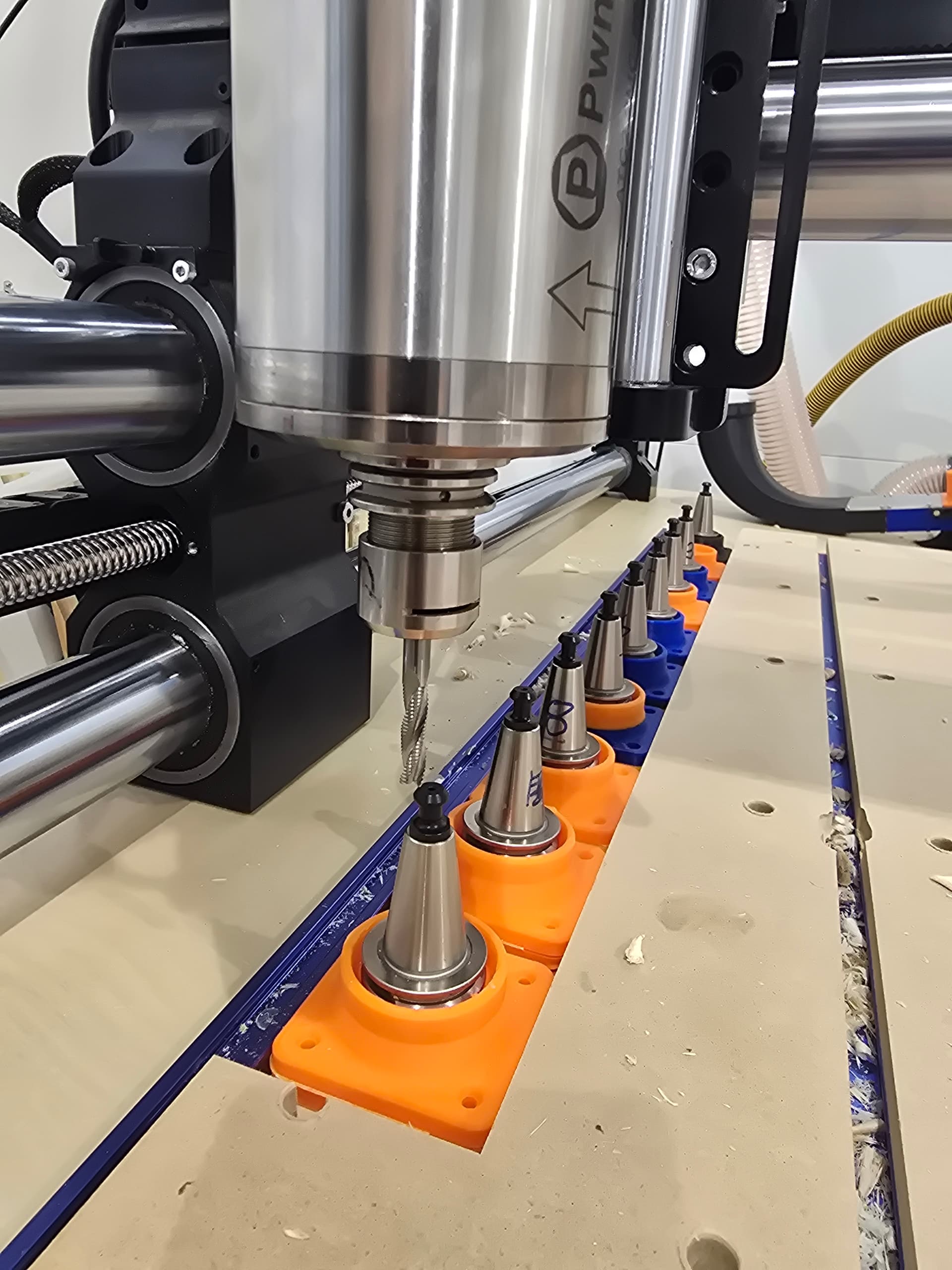

I am setting up my onefinity for the first time
My PMC spindle bottom flat is only 5. 3/4 " off the spoil board at top of z. (I did lower as per support as hitting z hard limit error). It is still doing the same z hard limit even after lowering the spindle.
-as in the picture I have the tool holder mounted on the table not the spoiboard so that if using a 4 foot wide board I can remove the tools and top holder and have a 4’ sheet
When I initiate a tool change in midi.it goes in the holder fine but doesn’t drop the tool and then goes up and stops with a z hard limit.
I understand that it means it’s reached its limit but if I mount the spindle any lower the bits will hit the other tool holders
The bit tip s only 2.5" off the table
My spindle bottom flat is only 5. 3/4 " off the spoil board at top of z. (I did lower) It is still doing the same z hard limit.
Any help would very much be appreciatedif
