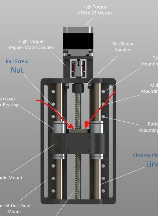

Thank you for providing this. Could you please tell me the centre to centre dimension for the two holes that attach the ball screw nut to the top of the mount, as well as their depth, and type of screw used? Also, do you happen to know if there is a particular place the set screws for the linear bearings should (or should not) go so as not to compromise their function?
Thank you, Tom
Could you please send me a picture of what you are asking.
Thanks
I have come up with a new design where I will no longer need the set screw locations in my second image. I will use a similar clamping system to the one I am using with my 80mm spindle. Added benefits will be easy access from the side, lack of set screws that could damage the housing of the linear bearing, and no longer needing to rely on a possibly tricky pressure fit. I would still appreciate help with the mounting hole locations in y first image. Thank you.
I was hoping to get your help with a final dimension I need. No one has answered my previous posts so I will try again. I have completed my 80mm mount design but need to know the size and exact (centre to centre) locations of the lead screw ball nut screws that fasten it to the top of the mount - see picture. I would really appreciate it if you or someone else could help. I had mentioned before that I appreciated your upload to Thingiverse, and that I had tried to get the dimensions using the STL, but I can’t seem to get an accurate solid body in F360 to trust my measurements.
