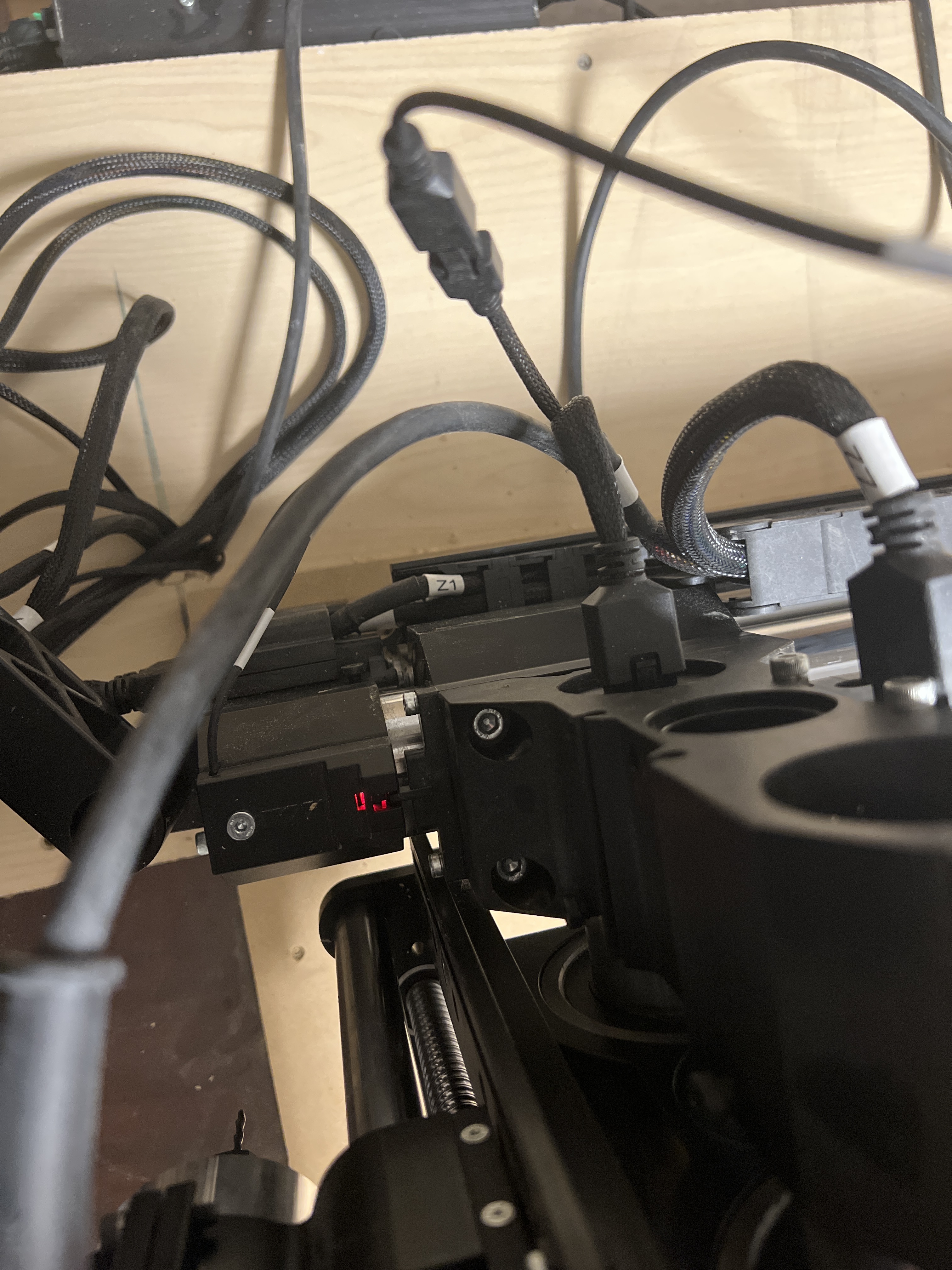

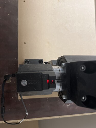

Need help with homing 1F Elite, when I press homing I’m getting “alarm Homing error”
When I jogging all sides are good but when I homing two sides going to the sensors left side stays at the sensor but right side only pushing away from the sensor about 1/4, and I’m getting same error.
Please help if anyone knows.
Sorry if confusing explanation have video but too big size.
I tried switching home sensor to the router and have no problem to home, I guess my home sensor was bad. Which is weird I didn’t even used the machine.
Problem solved by updating software. Thanks for customer support!
