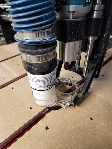

I have a 1.5HP Delta dust collector, running through an Oneida dust-deputy, and a 4" capable dust boot that I 3-d printed (on thingiverse and Etsy). I want to upgrade to a larger dust collector so I can run something else in the shop while the 1F is working - the V-3000 is on my short-list. Sounds like you have had good luck with yours!
I know people like their shop-vacs and the smaller dust boots - but I have had great luck with a 4" connection and a real dust collector.

Having issues with dust collection. I bought the 750 CFM Dust Right dust collector that has a 4" input. I have put a 4" “Y” to two 2 1/4" ports. I have a 2 1/4" hose connected from that to a suck-it dust boot. It barley collects any of the dust/chips. Looking for thoughts / ideas / suggestions. I hooked a shop vac up to it and it’s like night and day difference.

Do you have anything connected to the other 2 1/4" port on the Y? If not, most of the airflow will be through the port with very low static pressure (the open one) and hardly any through the port with very high static pressure (the one with the long length of flexible 2 1/4" hose).
Have a look at 4” dust boots and then ditch the reducers and wye. The reducing takes its toll. Take advantage of the full 4”. This one has a lot of good reviews. I bought it but don’t have my 1F yet to fully test it. Well designed.
I have both the 2.5" and 4" versions of the Nighthawk boot. I’ve been very happy with the 2.5", but wanted to move to the 4", mainly to get away from several dead shop-vacs over the last year. I hope to be switched over to the 4" boot and hoses with a new Harbor Freight 2 HP dust collector in a week or two.
