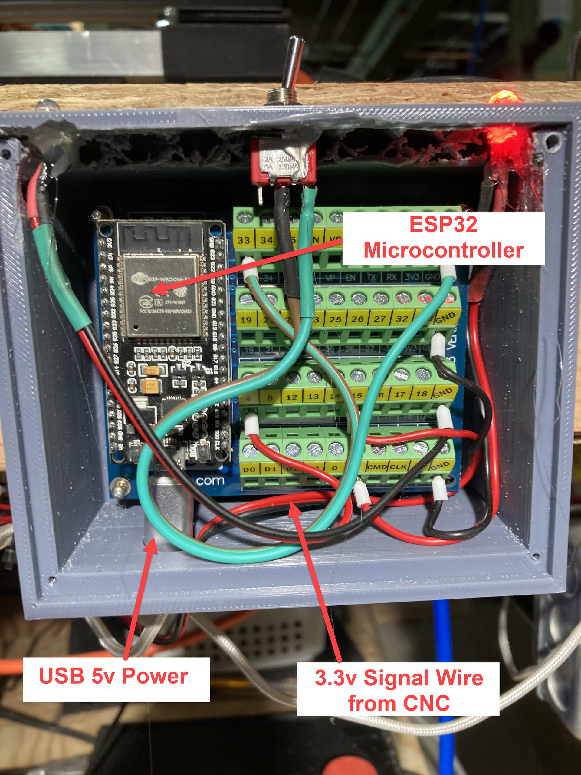

Grey plastic box thingy (with lights) that turns Makita router and dust collector motors on and off automatically by way of signaling a Home Assistant (home automation server) when Pin 15 on the Onefinity Breakout Board Adapter goes high, which in turn will control two off-the-shelf smart switches.
Primary Responsibility
Act as a signalling device to my home automation software so it can turn the smart plugs (switches) on and off accordingly
NOT intended to control the motors directly, only to signal something else to do that process
Allow manual override of all signals (physical safety switch) to prevent motors from turning on when not desired
Optional: Allow easy manual control of both spindle and vacuum motors in case of malfunction
Main Guts:
  • ESP32 (ESP-WROOM-32 model) Microcontroller (WiFi and Bluetooth)
  • ESP32 screw terminal breakout board
  • x1 Red, x1 Green LED
  • Double Pole —> Single OR Double Throw Toggle Switch

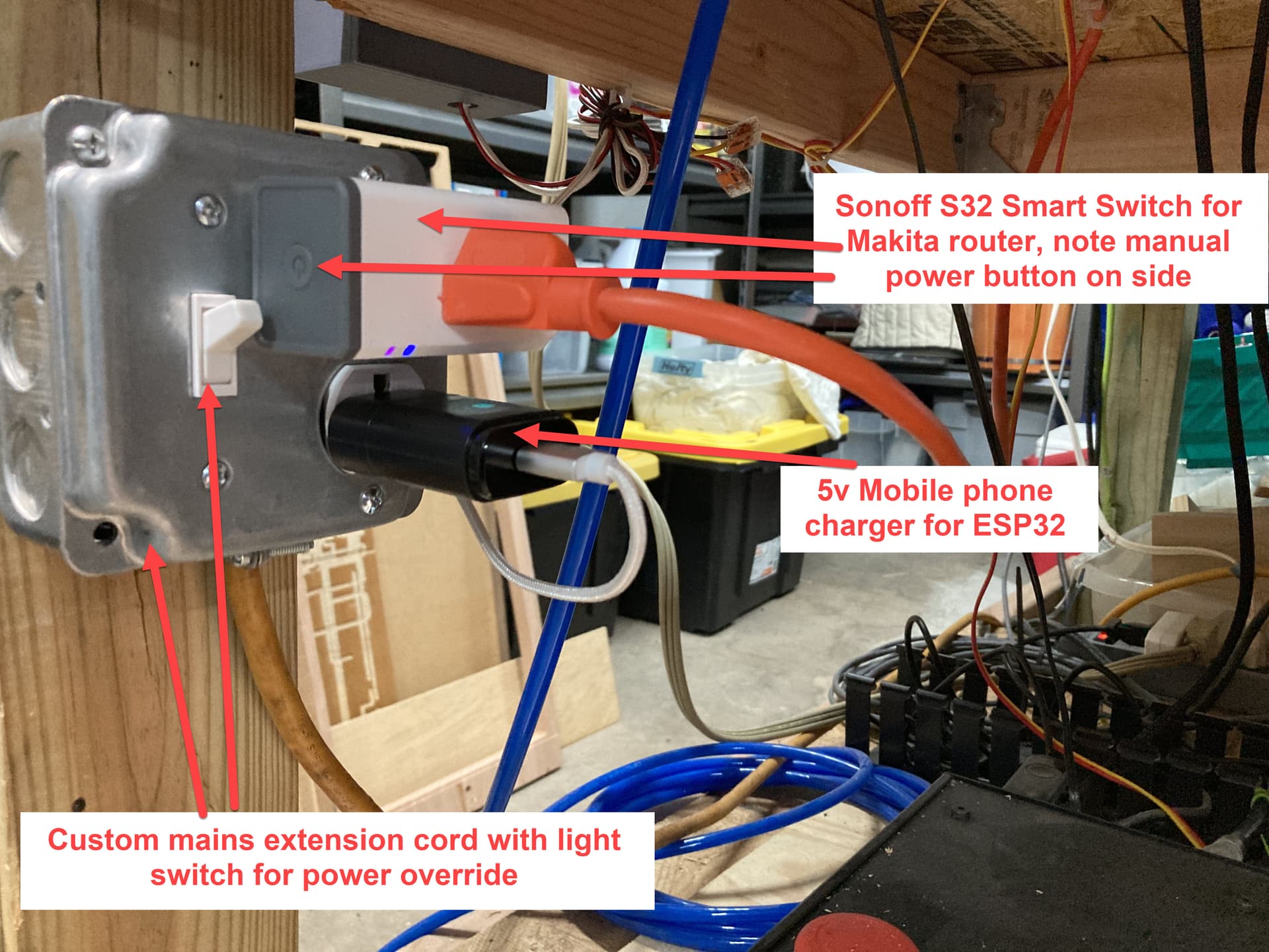

  • Custom mains power extension cord with a double-gang box containing a light switch which controls a duplex power socket
  • Custom designed square-ish box in FreeCAD and 3D printed
  • Assorted wire, solder and coffee

  • Sonoff S32 Smart Switch Flashed with ESPHOME (Makita router)

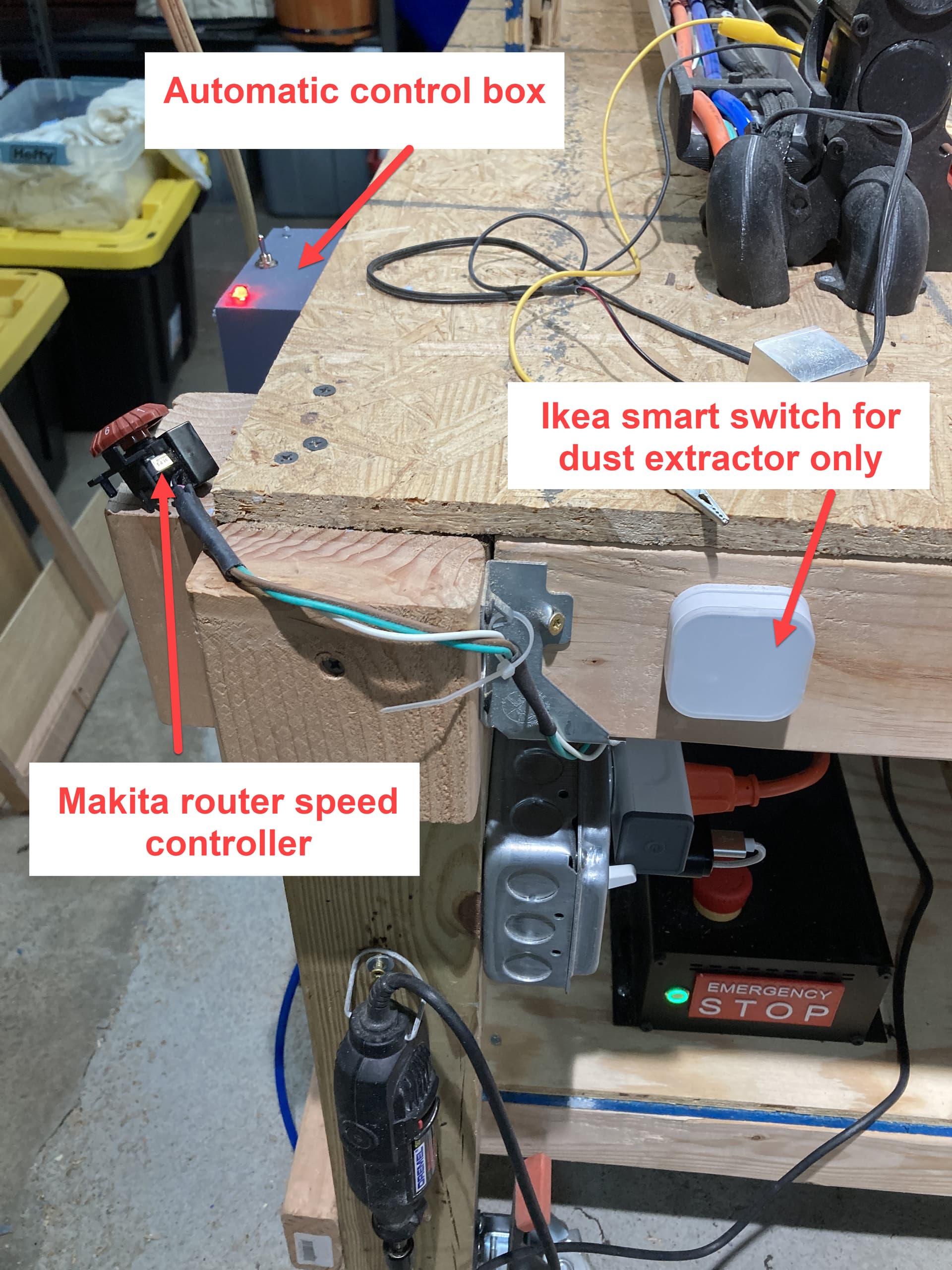

  • Ikea TRÅDFRI Shortcut button (smart push button) connected to Home Assistant via MQTT to manually control the dust collector motor

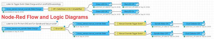

  • Node-Red for Home Assistant (flow-based development tool for visual programming)

  • Custom made extension cord with a double-gang electrical box at one end which contains a light switch and dual power outlets
  • USB 5v mobile phone charger and cable for powering the ESP32 microcontroller
Basic Workflow and Operation

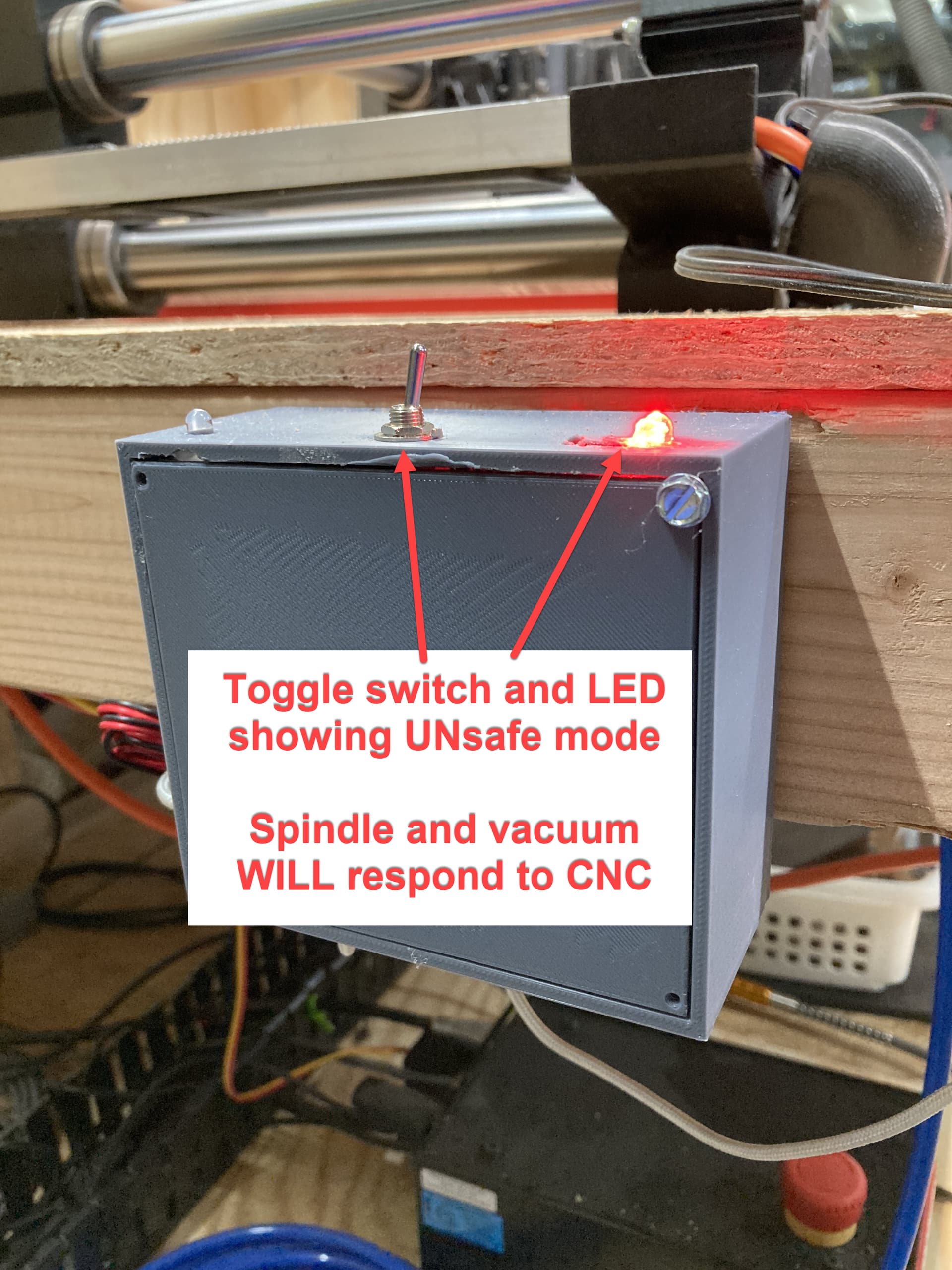

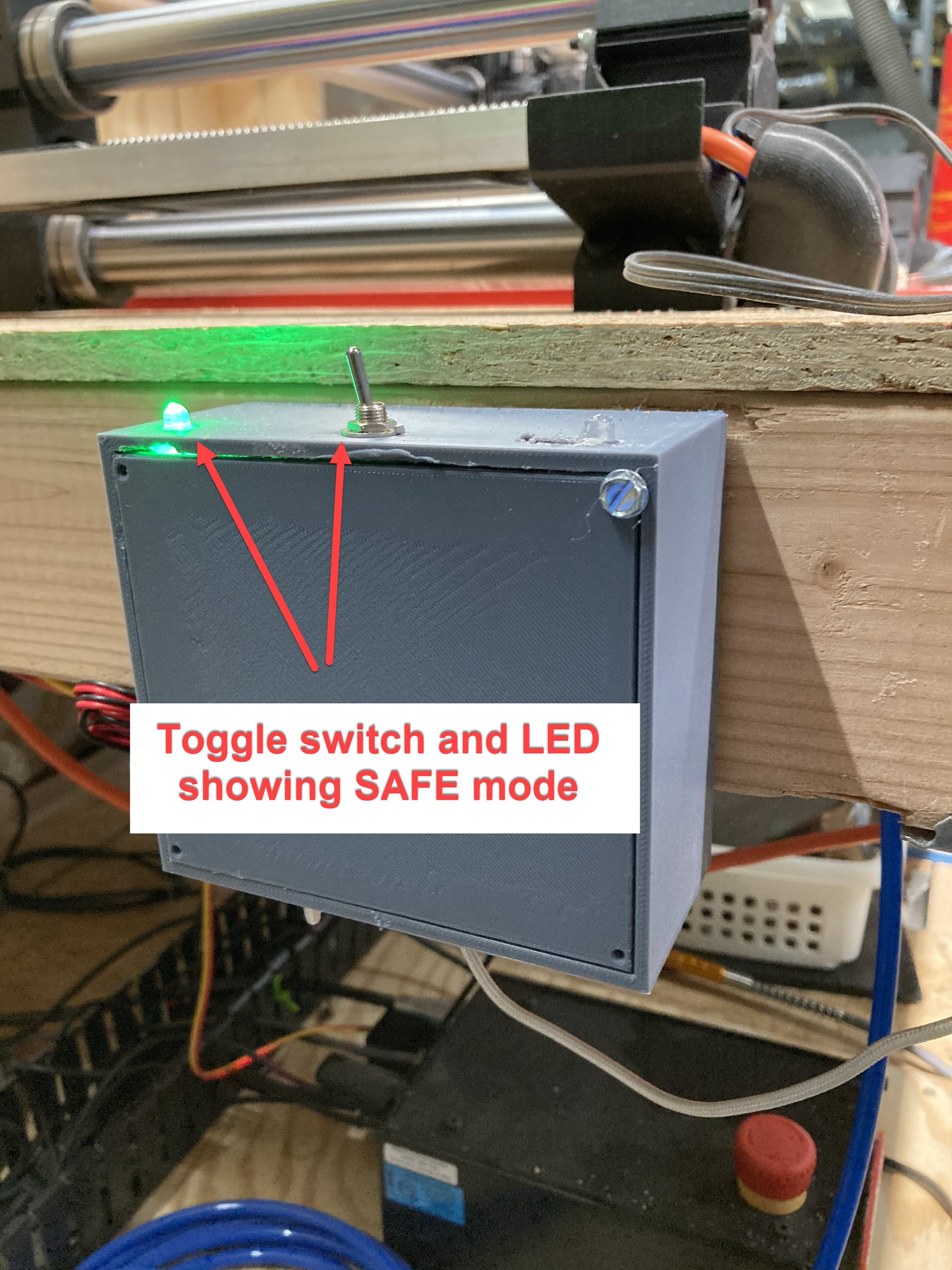

When the toggle switch is moved, this signals my home automation server to talk back to the control box and tell the microcontroller to turn on or off either of the LEDs. This process is separate and independent from anything dealing with the CNC machine. The ONLY function of the toggle switch is to turn one LED off and turn the other one on. Back and forth, that’s it.
With the toggle switch in the safe (green LED) position, the home automation software will ignore all signals from the CNC and do nothing.
In the unsafe (red LED) position, anytime a 3.3v signal is detected from pin 15 on the CNC, the automation server will send a “turn on” signal to two different smart switches. And if a zero voltage is detected, the switches get sent the “turn off” command.
NOTE: If the safety toggle switch is turned to safe (green) AFTER a program has started on the CNC, the router and vacuum will NOT turn off after the program is finished and will require manual intervention.
If this control box ever fails or is in safe mode (ignoring the CNC signals), then simply pressing the Ikea button will turn on the vacuum, and the Sonoff smart switch has a manual override on/off button built into the side and will do the same. This way I can run the vacuum for cleanup separately from the CNC control.

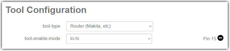

The only setting I had to make on the Onefinity is under SettingsTool and configured “tool-enable-mode” drop-down list to “lo-hi

You don’t need an automation server to do this. I have been using Home Assistant for a few years and it just made sense to have it control everything. So, using regular relays, with an extra toggle swith as you mentioned, should work just fine. The only thing with this is making sure the relays support 3.3 volts for triggering (and not more like 5 or 12 volts), and you will have to either connect both dust collector and the spindle to one big relay, or two smaller ones where you will have to split the 3.3v output from the 1F, or daisy chain the relays together. And, if not mistaken, there are regular looking power strips that have screw terminals where you can connect a wire from things like a 3.3v signal from the 1F, and will turn multiple outlets on or off.

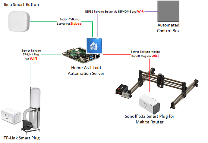

I know of 3 major wireless technologies when it comes to IoT devices; WiFi, Zigbee and ZWave. I don’t have any ZWave devices and the Ikea smart buttons are using the Zigbee communication protocol and radio frequencies. The ESP32 controllers are only using WiFi for connectivity. So
Obviously nothing is totally hacker-proof, but to my knowledge, Zigbee uses encryption during transmission as does WiFi. I have not done any direct comparisons between the two in relation to security, but feel more than comfortable using Zigbee. Just to note, other things that use Zigbee include my Philips Hue and Ikea light bulbs.

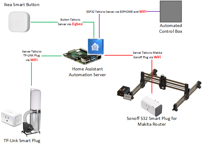

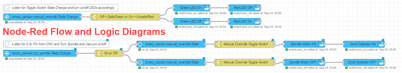

I am only using an Ikea button for the dust collector because they were inexpensive and I had a few extra just sitting around. I am not using Bluetooth on the ESP32, but just the WiFi radio only for connecting to the automation server. The software loaded on the ESP32 is called ESPHOME and only uses WiFi. Here’s a quick diagram that may help:
