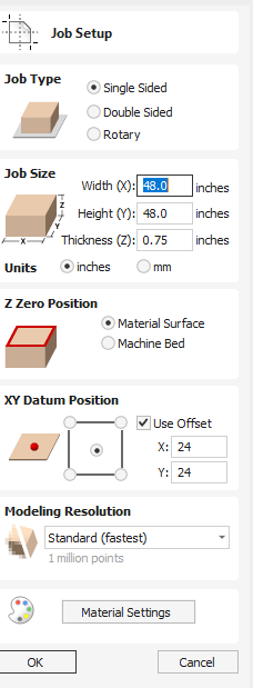

I am trying to be a fist time user of Elite Foreman, having trouble with the B Hard Limit Alert. I am running a job to setup my spoil board with screw hole and threaded inserts. I created the job in Vectric Vcarve Pro.
I have no issues jogging the machine all around the table. I have gone through the normal job setup procedures, Home Machine, set X, Y and Z, I wanted to do a dry run first so I went to MDI and selected Dry Run, Loaded File, move my machine to roughly the middle of the table, hit Rewind, hit Cycle Start(asks to load Bit), the machine jogs to the bottom left corner, then moves about 2 inches towards the first hole then triggers the B Hard Limit Alert.

A couple of questions- what’s your machine co-ordinates and what’s your job origin?
Secondly, I’m not sure it matters regarding the B alarm but your first Z plunge according to your g code is .43 inches that’s pretty deep for a single pass
Forgive me if don’t answer this correctly, i think its the same as home (bottom left) for this job, if I hit go to origin it takes me to the spot I tool probed, as for the plunge rate is that because I used a Drill Toolpath? Should I use a Profile instead?
Ok about the depth, I didn’t realize it was a drill toolpath.
Generally you don’t set the job origin to the machine home co-ordinates as the machine uses the limit switches to figure out the machine co-ordinates.
I suggest you run a program more inside the work surface, to make sure the alarm isn’t been caused by the job origin.
When first starting out, I always set my job origins to centre of machine. It allows you to figure out the machines reactions.
Are you saying to change my Datum Position in Setup to the center instead of bottom left or am I off in left field
Yes try that to see if it makes a difference in the alarm issue
make sure you set X0 Y0 to centre of the machine
When I surface my spoilboard, I always run from the center of the machine.
So use the Offset function and place to coordinates there X=24 and Y=24
For first time, I measure with a tape the centre of both x and y axis make a mark and then jog the machine so the bit is centred to the spot, then re zero out X and Y
Yes, that in the software, without the offset then do above for the machine
So I measured and found center, then I home machine reset x and y then jog machine to where my center mark is and wrote the coordinates. Not to be a D___A__ then where do I input these coordinates as a new Offset or somewhere else

I’m trying to get you away from the limit switch on the machine.
The onefinity only has about .25 of an inch bigger than than 48x48 so there’s not much wiggle room starting out.
I suggest you start from the centre of the machine and job origin set to centre of the job so you can test to see if the job is outside of the cutting area or not

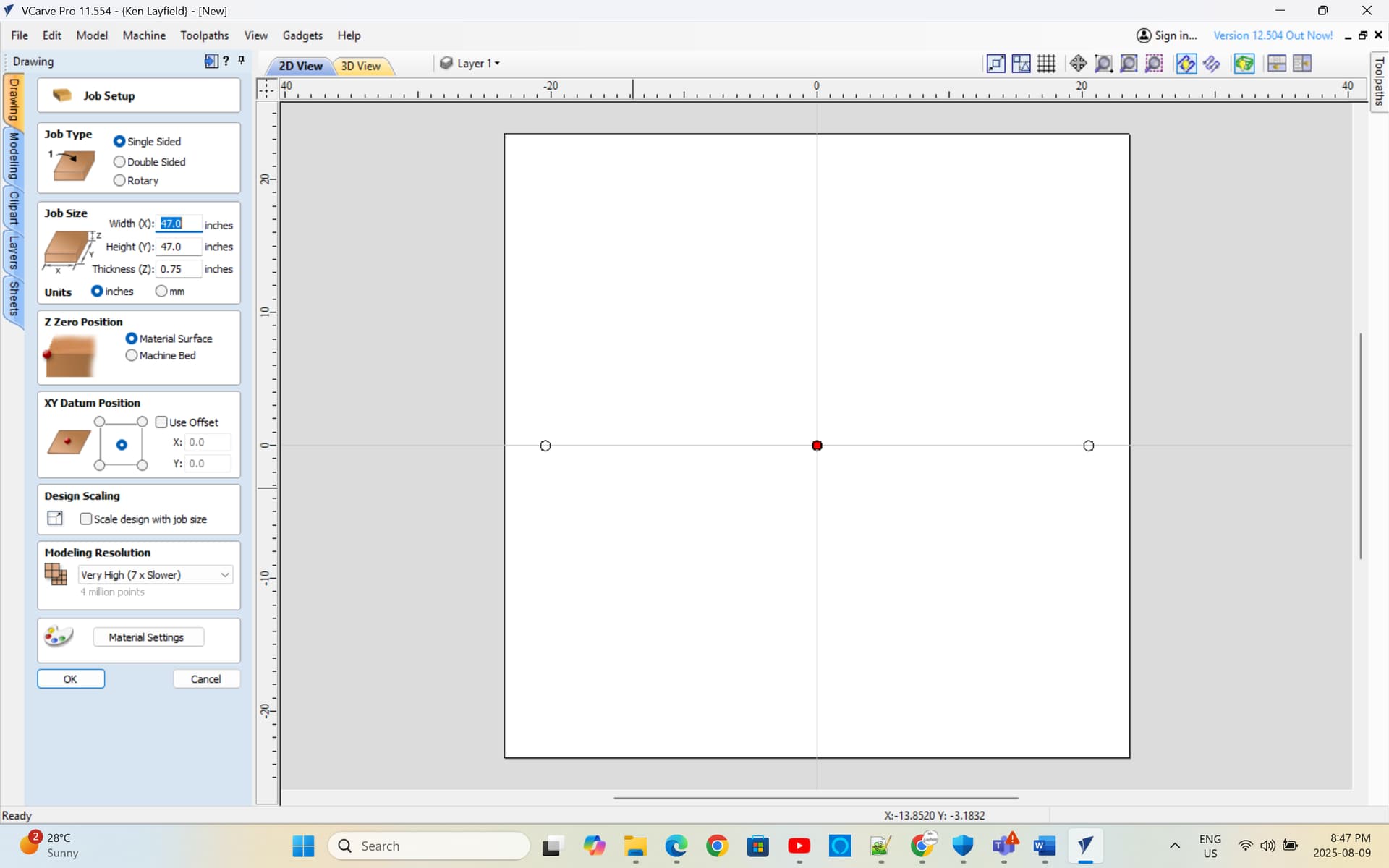

How do use show the crosshair pointer
The red dot is just the job origin mark. You can set up guides too if you want.
So tell if I messed up I went to Tools and Offsets and change G54 to the center coordinates I measured and labelled it Work Origin
