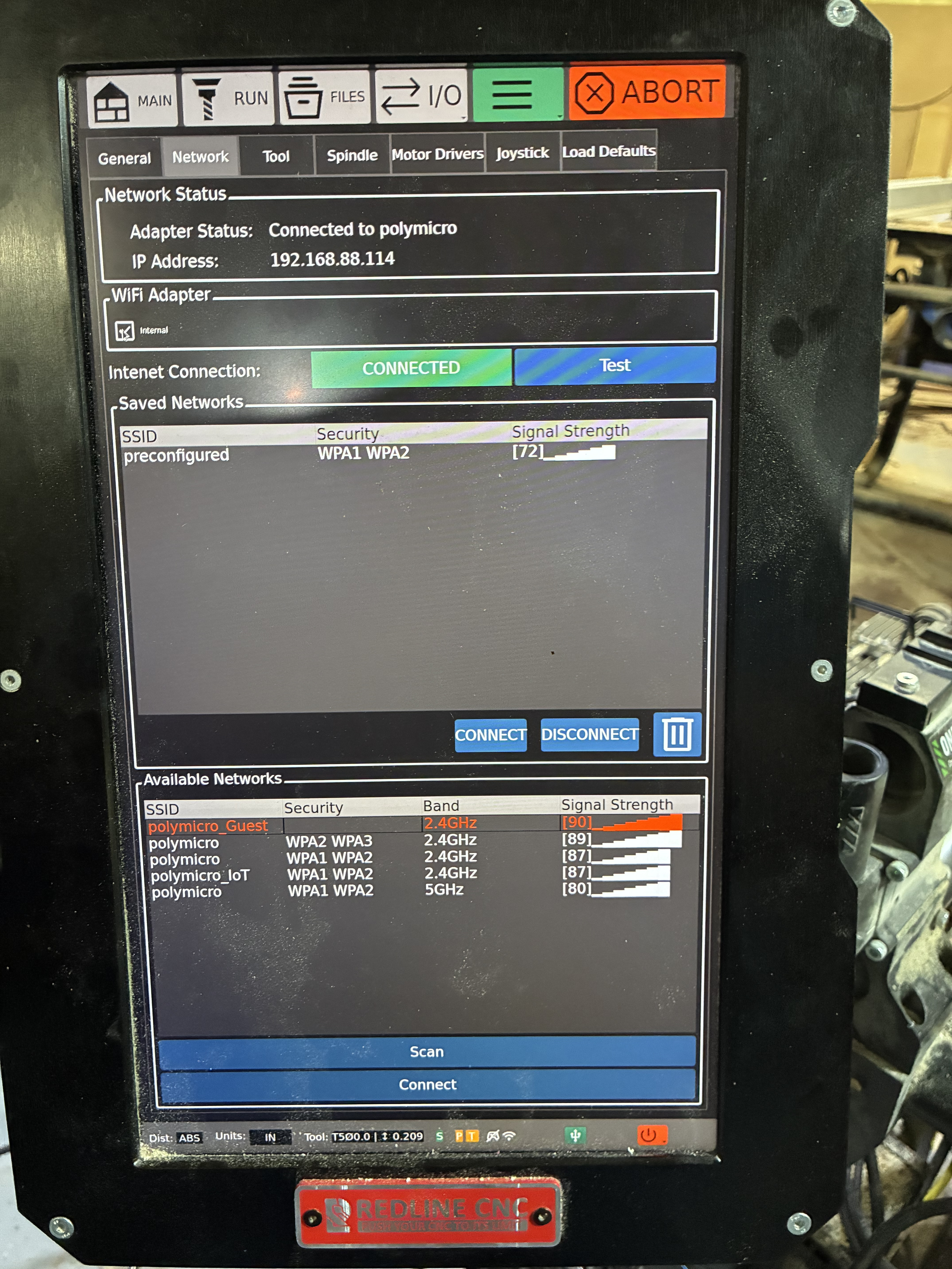

I have a wireless issue too. My SSID has more than one AP. Normally computers show only a single SSID but yours shows one per AP. When I pick the strongest signal one, that doesn’t seem to be the one it tries to use to connect and it fails. I created a special SSID just for the RTC controller and pinned it to the AP radio closest to my shop. That works. When you work on the networking features please be aware of this issue when there are multiple access points for a SSID.

In terms of the networking on the Redline version, our software gathers the network info from the operating system. It seems to be reporting some 2.4GHz and 5GHz separately even if they are the same SSID. Our team will investigate.
