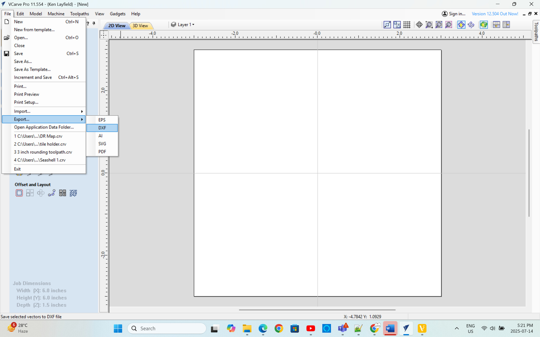

I’m not sure about the other Vectrics software offerings but Vcarve Pro can export as a DXF.
