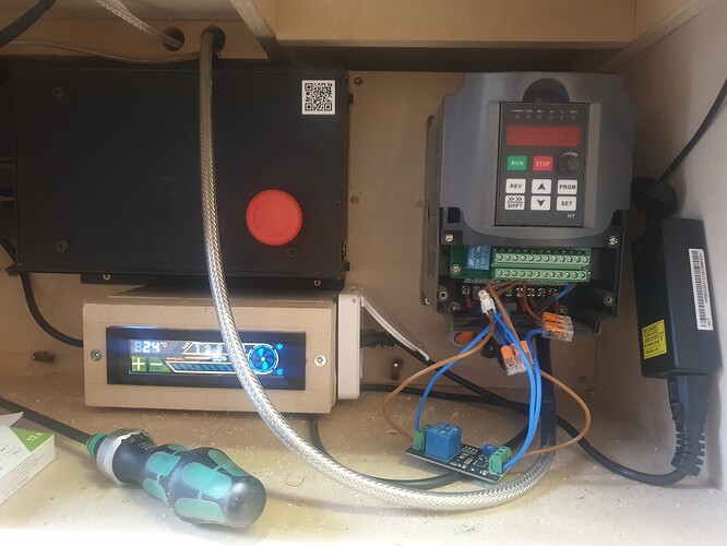

Hey Fred,
rather this way:
As you see, the SSR works as normal from FC and DCM when VFD is in RUN state. If it turns to STOP, then FC cuts the power, but FC still goes to the timer module and triggers X1 by being cut (hope logical low triggers) and if the module works as we expect, the SSR is still fed over the rose wire so pump stays on for the delay time. The timer module always has DC+ to +24 V so is always fed.

Hey Fred,
did you select Function 4:
Function F4:
Level-triggered mode: the relay is disconnected when powered on, and a high-level signal is given to the X1 interface, and the relay is closed immediately. After the X1 port signal disappears, the relay is still closed. When the pull-in time T1 arrives, the relay is disconnected.
PD052 must be set to 1 “Act when receiving RUN command”.
PS: Be aware of correct polarity of all components (+ and -) especially SSR control input!
“+24V” on VFD is DC+ and “DCM” is DC common, which means DC−.
“FB” is (VFD relay output) Common and “FC” is (VFD relay output) “Normally open (NO)”.
(The reference I use is HY01D523B-VFD-Manual.pdf)
Select Function 4 on the module.
The SSR should switch your pump on at least, as it is wired the usual way. On your first image above, you reversed polarity on the relay!
If you checked everything that I mentioned, does the pump go on if you select RUN the VFD?
If so, but the pump does not stay on with a delay after returning to STOP, then you can try the following: Put the VFD in STOP mode, and bridge X1 and DC+ of the module. Does the pump on the SSR then go on?

Hey Fred,
can you measure whether the 24 V voltage breaks down if you use the diagram and the VFD does not turn on. It may be possible that the 24 V from VFD is not capable enough for the module. Unfortunately the Huanyang manual gives no current rating for this 24 V output.

So the ssr wiring is good. The - on dcm and the + on fc.
For p052 if I set to 1, the pump starts instantly even if the spindle is stopped
Since nothing lights up, I think I would have 0 v. But I want to measure
Did you connect to “Normally closed” (FA) output instead of FC? This would explain inverse behaviour.
Or instead of +24V do you have DCM connected to FB?

My wiring
or the terminal block does not correspond to the internal wiring
Why fa/fc/fb and not fa/fb/fc ?
Wiring on your image looks correct and corresponds to manual.

What about +24 V voltage when you have connected the wiring above and VFD does not turn on? Can you set your multimeter to DC and measure whether the voltage breaks down?
I am to reconnect the trm01 to measure.
For the multimeter I put it on 200, one clip on 24v and the other on dcm?
For measuring the +24V to DCM, “DC” ( ⎓ ) setting is important on the multimeter, not “AC” ( ~ ).
Nothing.
Multimeter on 200 v dc.
One clip on the 24v the other other one on dcm.
What if you disconnect X1 from FC?
And what if you disconnect the DC+ of module from +24 V of VFD, then the VFDs goes on? If so, then I would test the module with a separate 24 V power supply.
