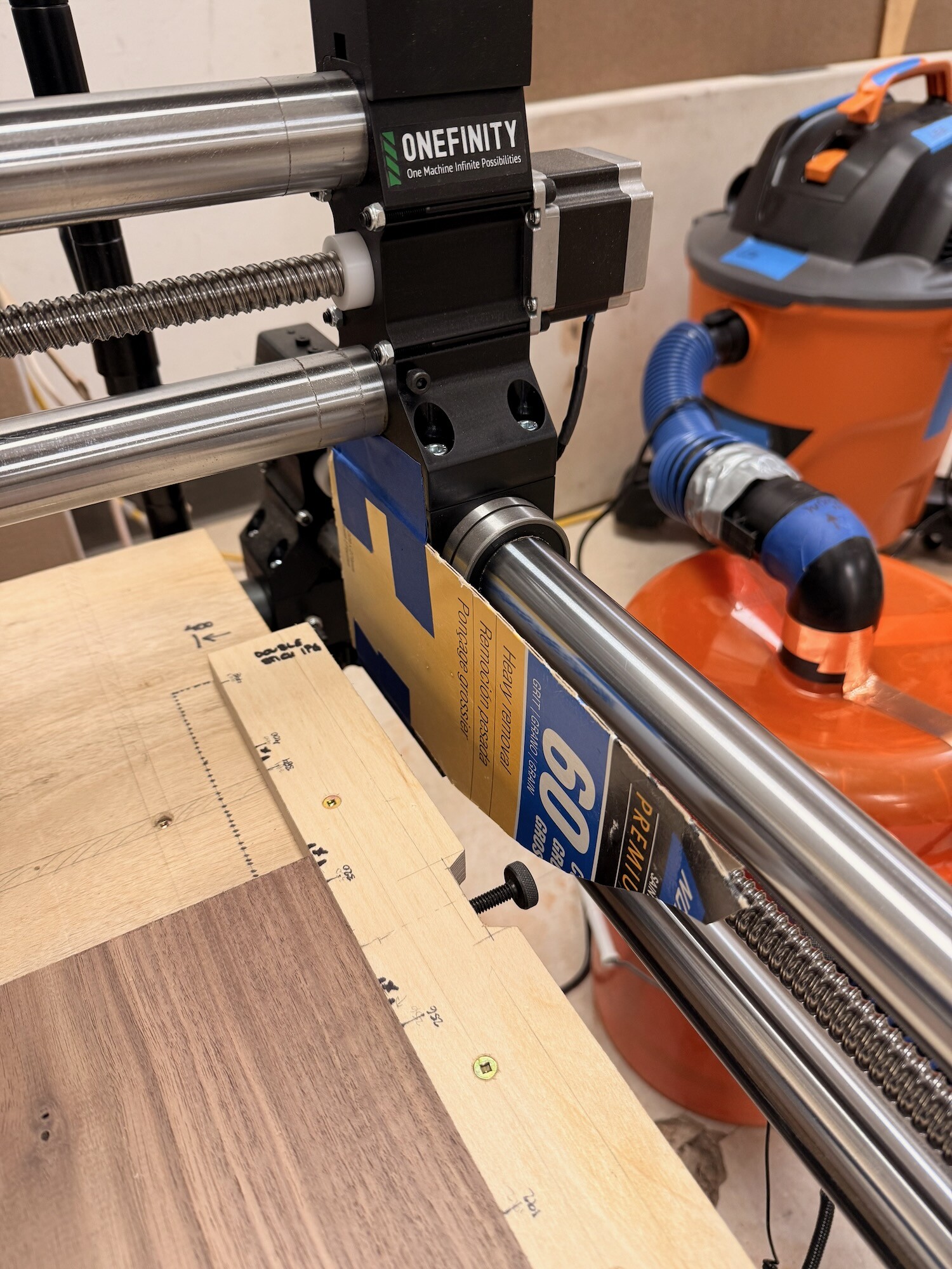

I’ve been trying to manage the amount of dust spray onto the rails and ball screws since the dust boot doesn’t go up/down with the Z axis. It’s super flimsy but it does seem to deflect a lot of chips (which then get stuck to the rails because of the oil).
It’s two pieces of spare paperboard taped to the gantry.

I like it. I use the same solution and it has worked well for a while now.
It has been many days of cutting and the little deflector is taking the hits like a champ. The rails and ball screw are so clean as a result. (There’s a pile of chips on the floor though.)
