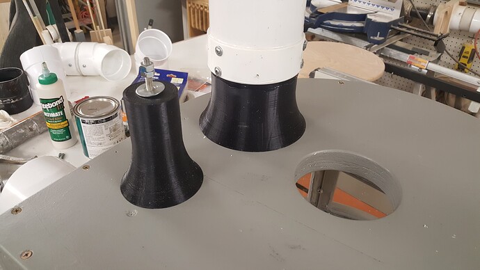

In my workshop, I use a 2HP dust collector (in a cubbie) hooked to a homemade Thien baffle (look them up on YouTube). Here’s a good example.
Mine is modified to include a 2 piece nose cone just above the baffle. I found that with this setup, a gap of 1 1/8" from the floor of the baffle to the bottom of the bell works best. In 4 years of operation, I have emptied many multiple barrels of chips and dust, but have only had to empty the bottom bag on the collector once (last year), and that was only a foot deep and it was super fine dust, like talc.

Nice! It would be very interesting to see if you also have better separation of dust if you installed a nosecone like I did.

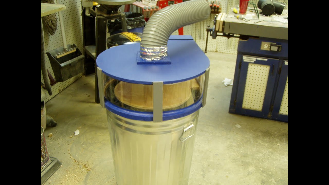

Here’s a shot of mine in action. Weight & vacuum holds it down on the barrel with foam gasket between.
I’ve noticed that mine seems to hold the fine dust in suspension high up until vacuum is shut off, and then falls into the barrel.

I initially made a Thien separator myself. Then bought a cheap plastic conical cyclone separator from Ali Express. I really think that conical cyclone works much better for me. I am using a ShopVac though. Better separation, less shavings get in the shopvac, and it never clogs. The Thien separator got clogged regularly, with hand plane shavings mostly. Mine was fit on a Home Depot bucket, so the slot was more narrow, may that was the reason.
I really do not see any reasons to build a cyclone, they are cheap and available.
Yes, you are right. Bigger ones are more expensive. However, I still think that conical cyclones are better, better performing. So, if you can afford it, get it.
