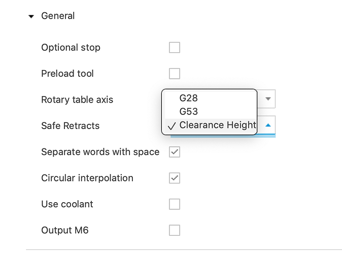

Hey gang… I’m looking for direction on editing the F360 post (r43242) so that the “G53 G0 X0 Y0” is not tagged onto the end of the NC file… that is driving the X and Y axis hard into the end stop and throws off the homing. I do want to keep the “G53 G0 Z0” so the z-axis retracts to home at end of file, but I want the x and y axis to stay in their last positions. I searched the post for “G53” but can’t make heads or tails of it. Thanks for your replies.

I found the solution… add comment mark (two backslashes) ahead of “writeRetract(X, Y)” in the post to omit.
You control this in the NC program. Select “Clearance Height” instead of G53.
Thanks… I now have a couple options!
