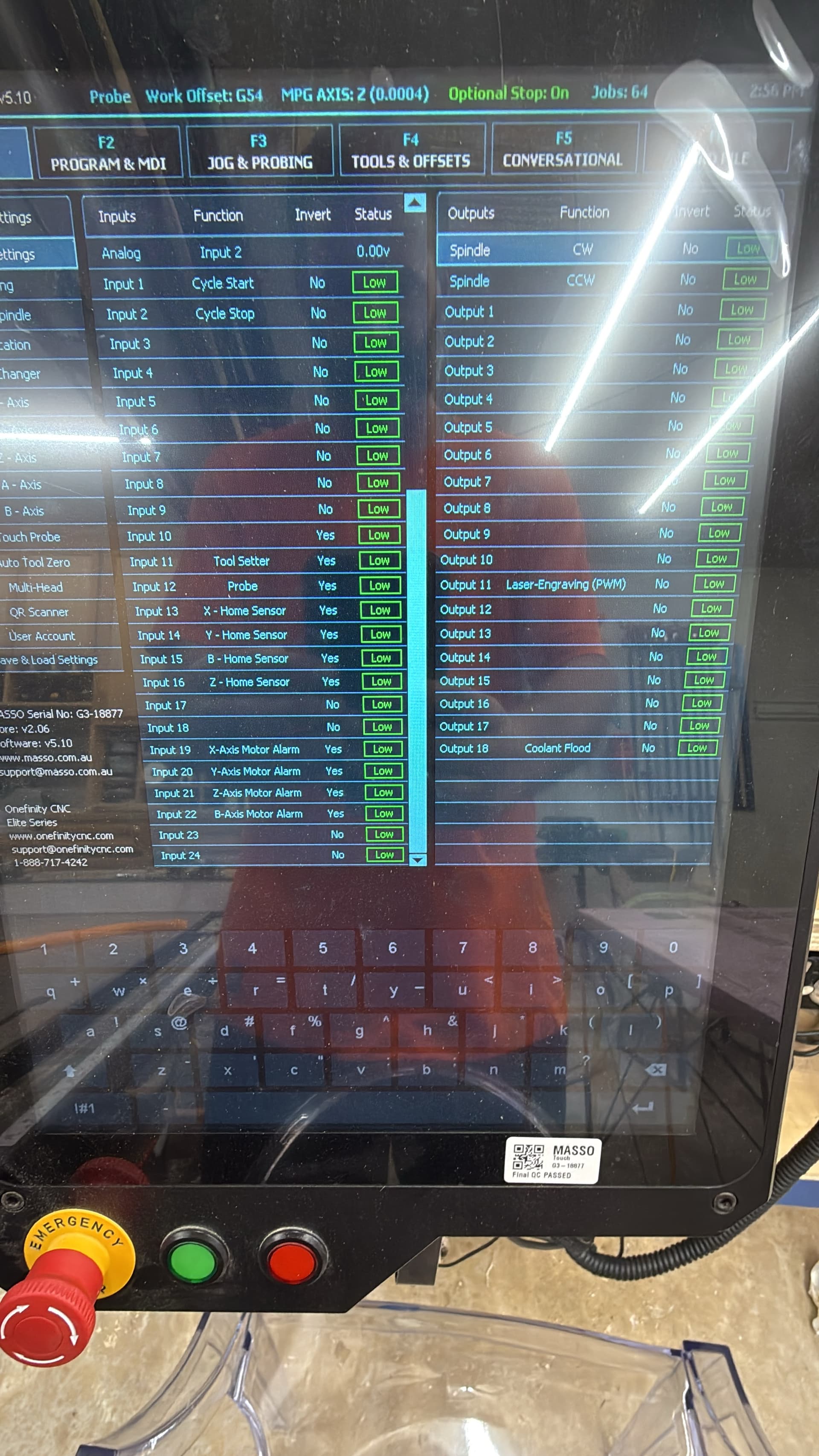

Onefinity elite will not home. It’s says it is but no movement and then I get a homing error. Pendent does not work either. Please help

Looks like your E stop is stuck on
I believe it should show HIGH when released.

I see Estop on at top of page (optional stop on)
estop line should be red high when the physical estop button is disengaged, and green low when it’s engaged. His looks right
My bad,
I assumed that the green Optional Stop- On at the top of the screen was refering to the E-stop (if not what does it refer to)
https://docs.masso.com.au/supported-m-codes/m01-optional-program-stop
