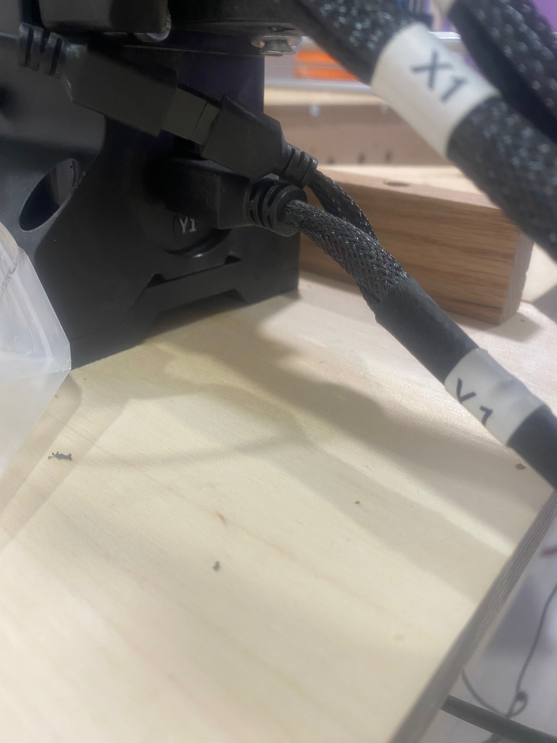

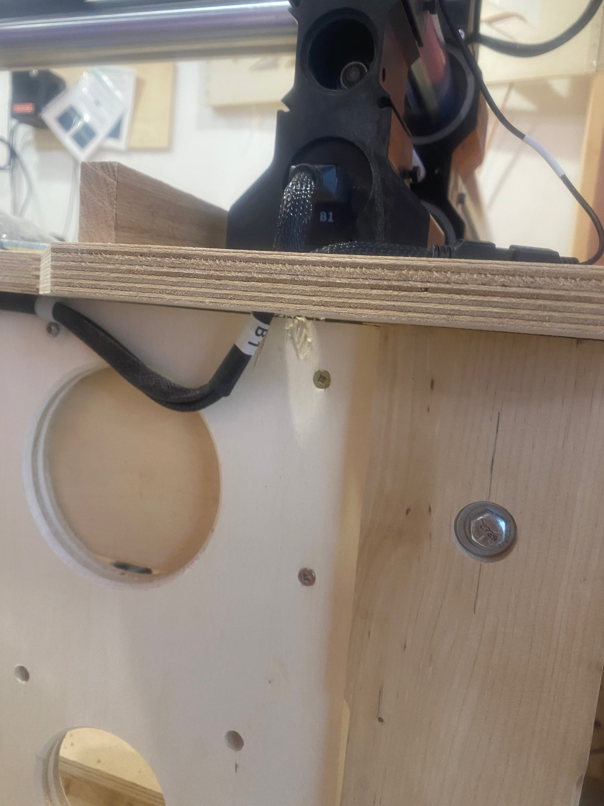

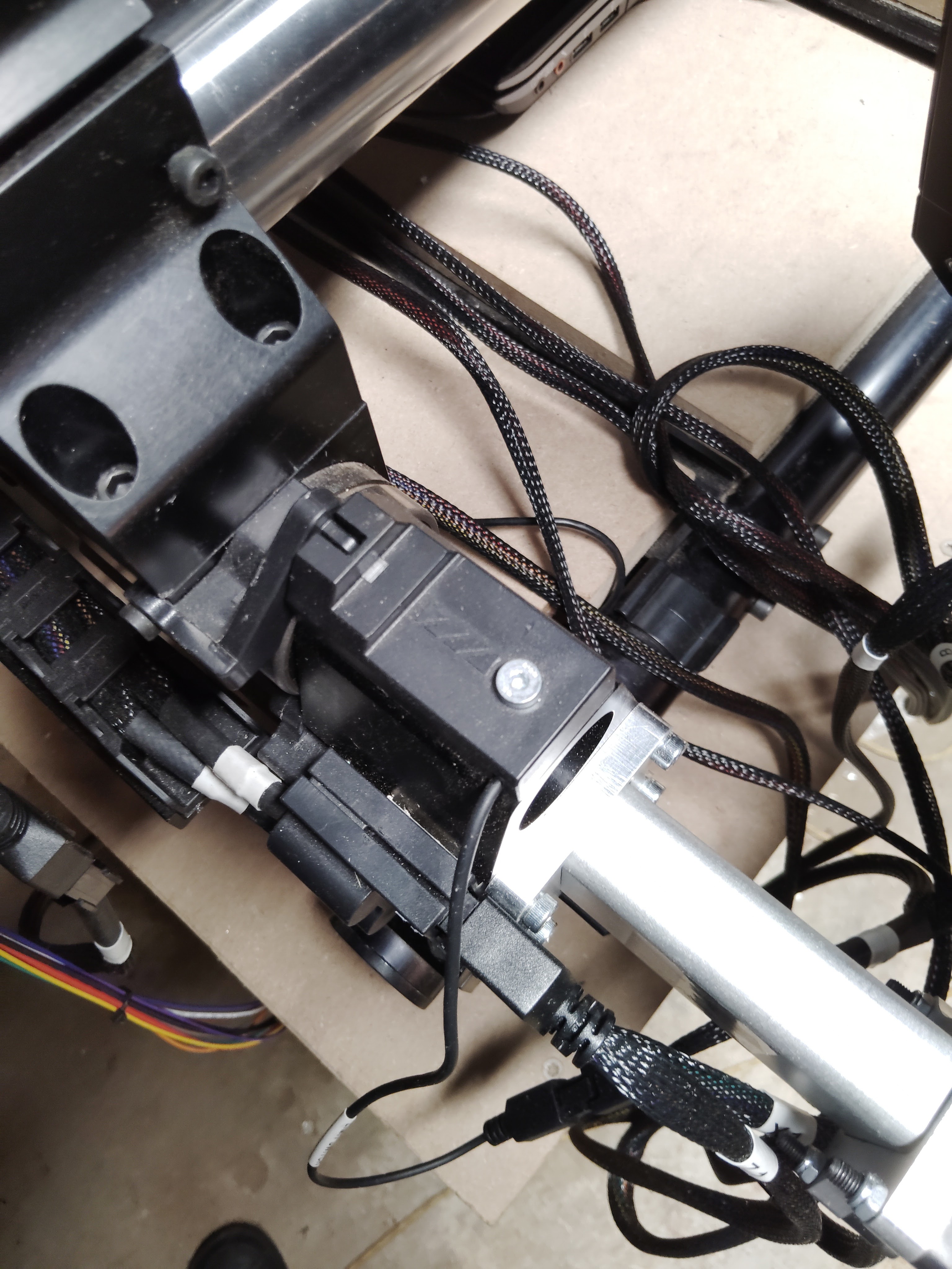

You probably already have checked this but do the cables match to the correct axis

Yeah that’s not right.
I would go through the post above and check those things that apply to your machine
It could be a bad wiring or mechanical like a jammed coupler screw or a too tight ball screw nut (#7)
Well, with a bit more fooling around, I think (at least I hope) that I may be on to something. in the two pics that you’d shown, above) my wiring is indeed proper. However, taking off that B-motor wasn’t nearly as challenging as had been previously thought. Having gotten that motor off,I immediately set myself to testing its ball screw rotating. As it turned out, that screw turned just as easily as the Y-side screw. So, apparently, the fault appears to be my own. I don’t see extreme closeups very well (even with spectacles on :slightly_smiling_face:), which is to say that finding those set-screws, through that tiny hole, is likely to pose an issue for me (as it did before). So, I’m laying things aside until tomorrow, when I can get one of my daughters (with better working eyes) to assist me. That motor released without its coupler, which leads me to feel that both set screws had not been secured in, and that the one that was had been really hand-torqued. Tomorrow, I will make certain that I don’t bear down, too tough, on either of those set-screws, and will report back to you with the outcome. WOW - maybe, just MAYBE I will be able to get some Christmas gifts done. HAPPY THANKSGIVING to you, and your loved ones. In fact, that sincere sentiment goes out to ALL members of my Onefinity family.

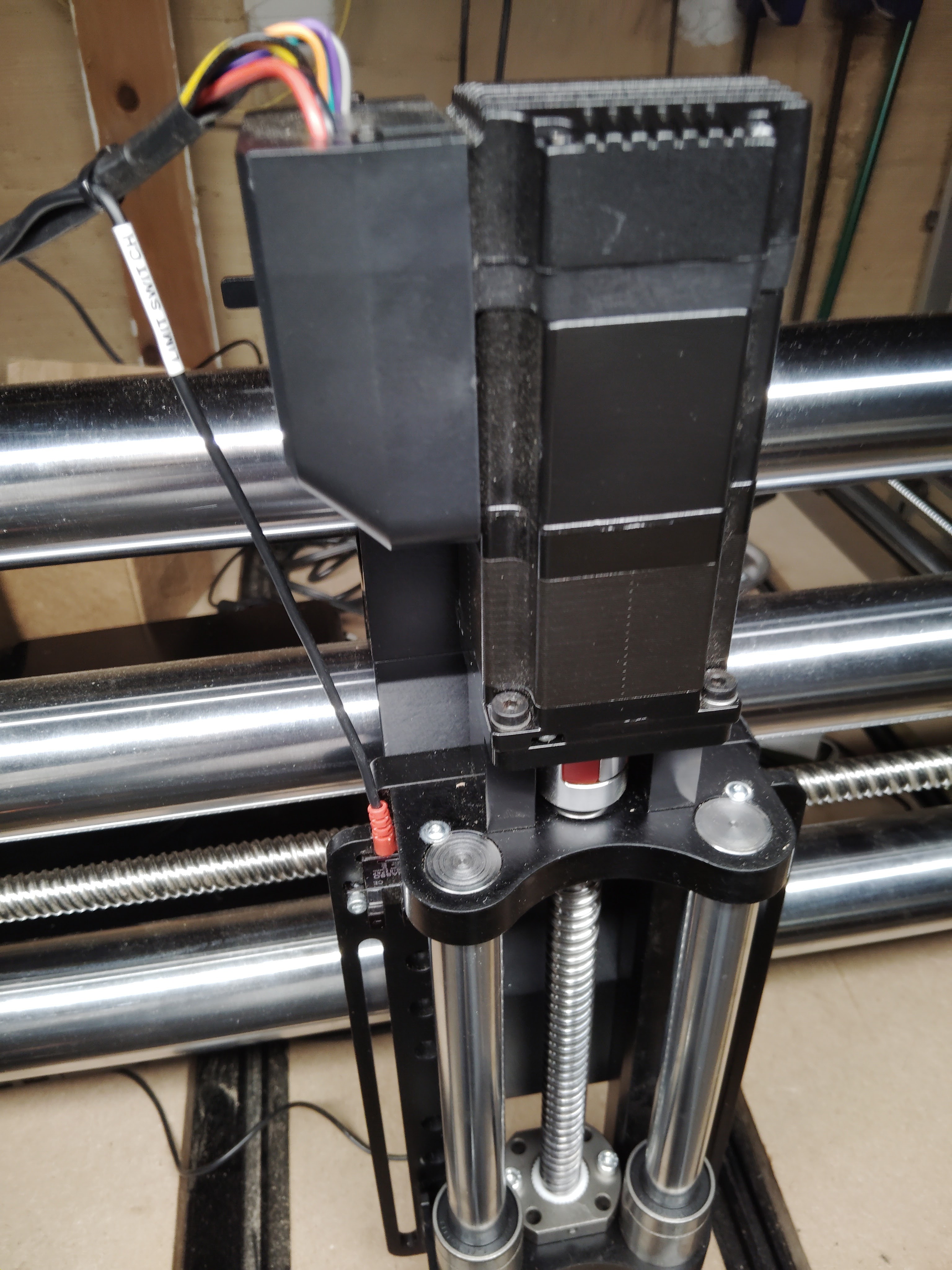

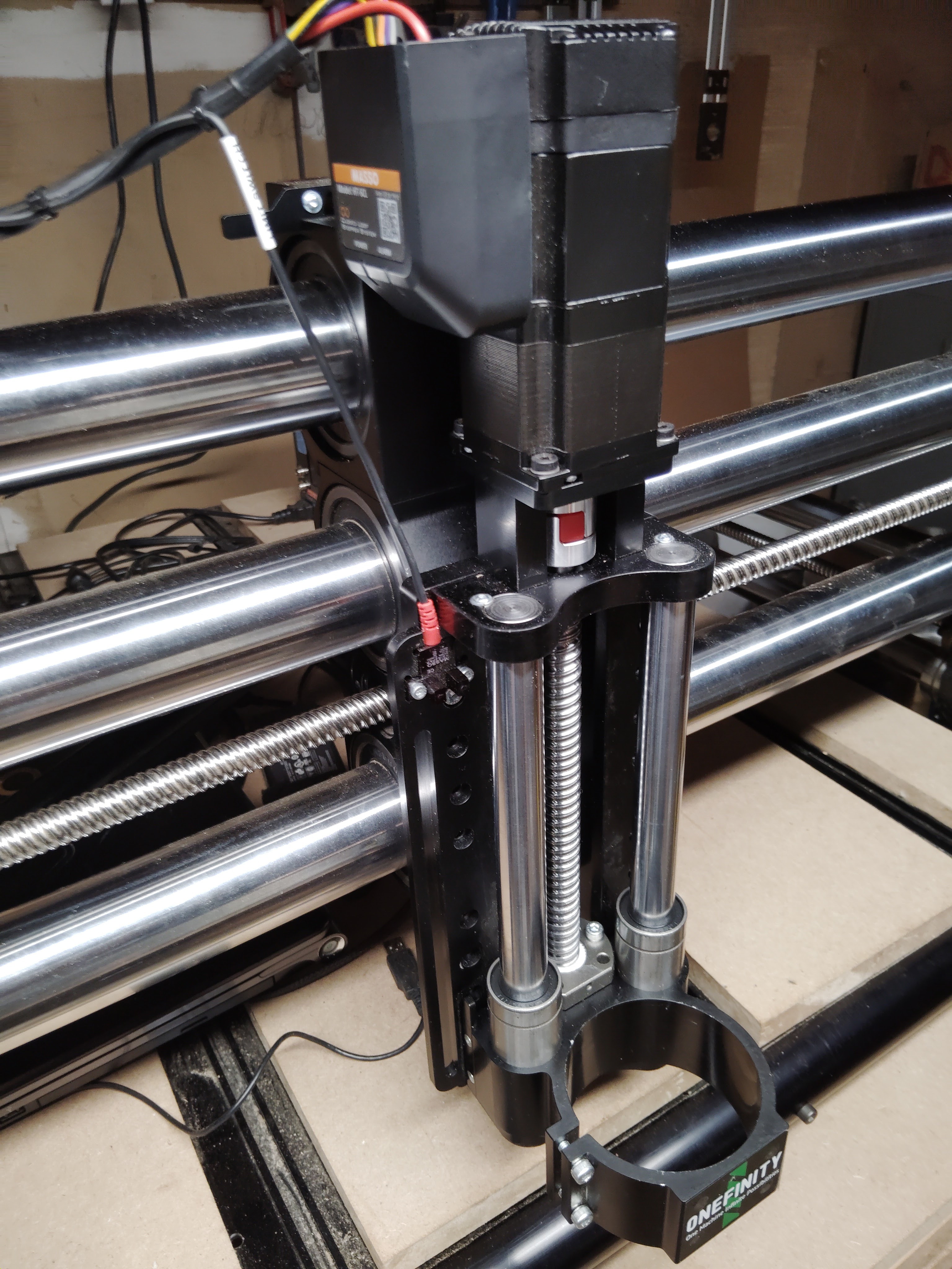

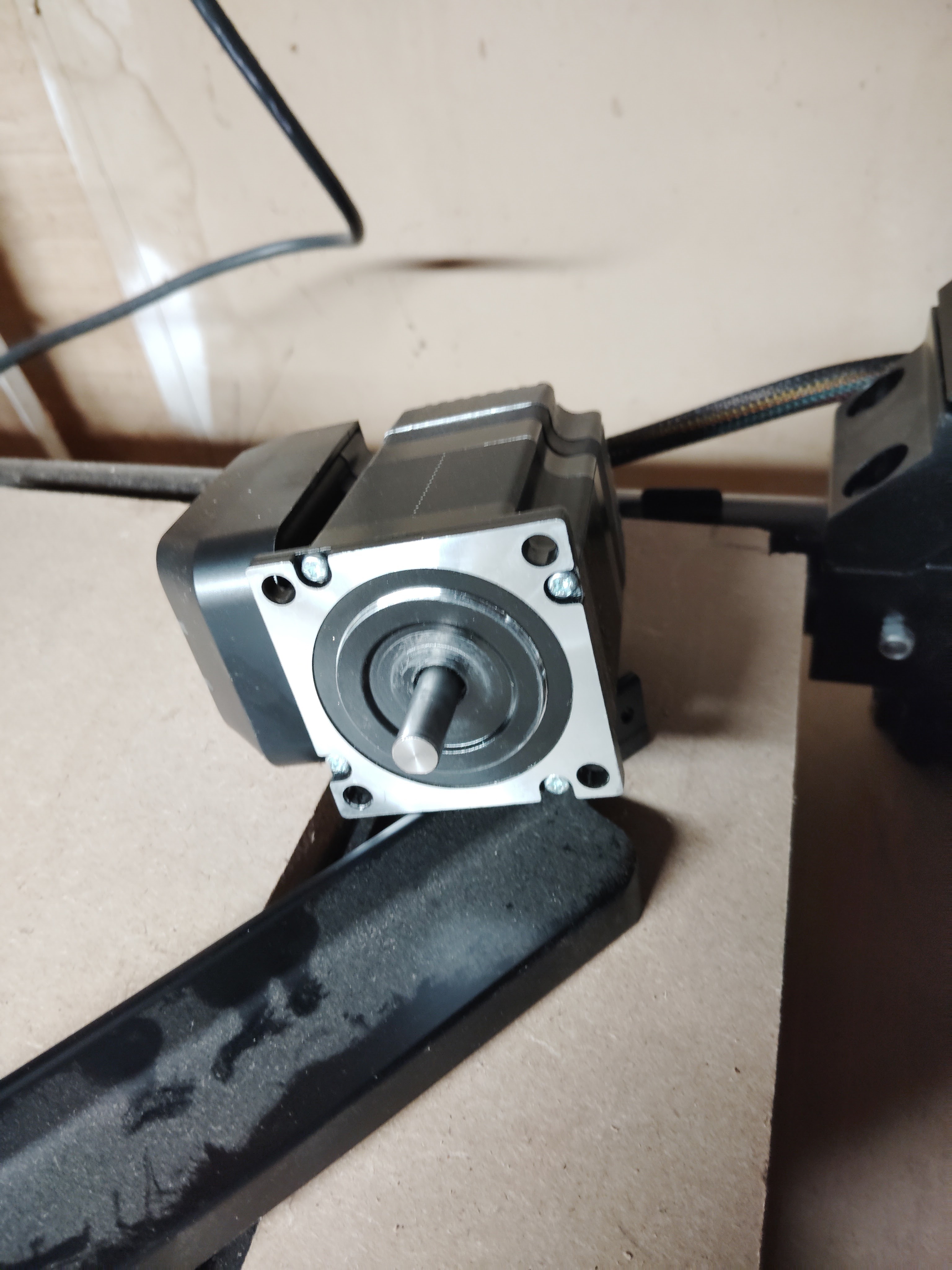

You didn’t pull the red plastic (nylon) coupler off the shaft of the motor did you? There’s a note about that in the setup instructions which suggests some folks did in fact did that.
I had one axis not moving the first time I fired it up and had to unplug/reattach the wiring connectors. I didn’t see anything wrong but that fixed it for me.

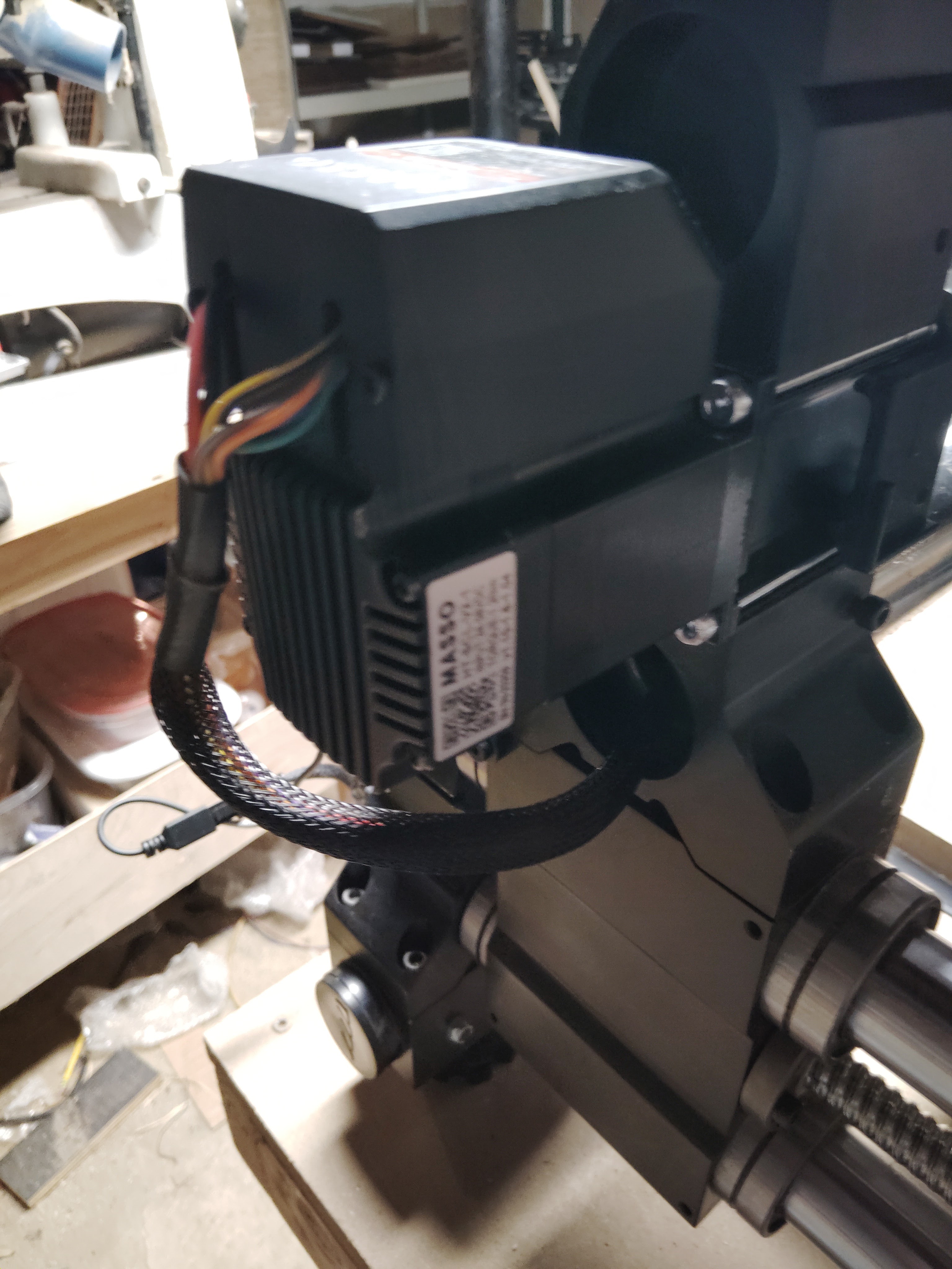

Hey Jim, no - I did not remove the coupler, or any part of it. I have attached a picture of the removed motor, in the way in which it came out. The coupler, in its entirety, is still resting in its location.
(attachments)
Welp, so much for the easy solution.

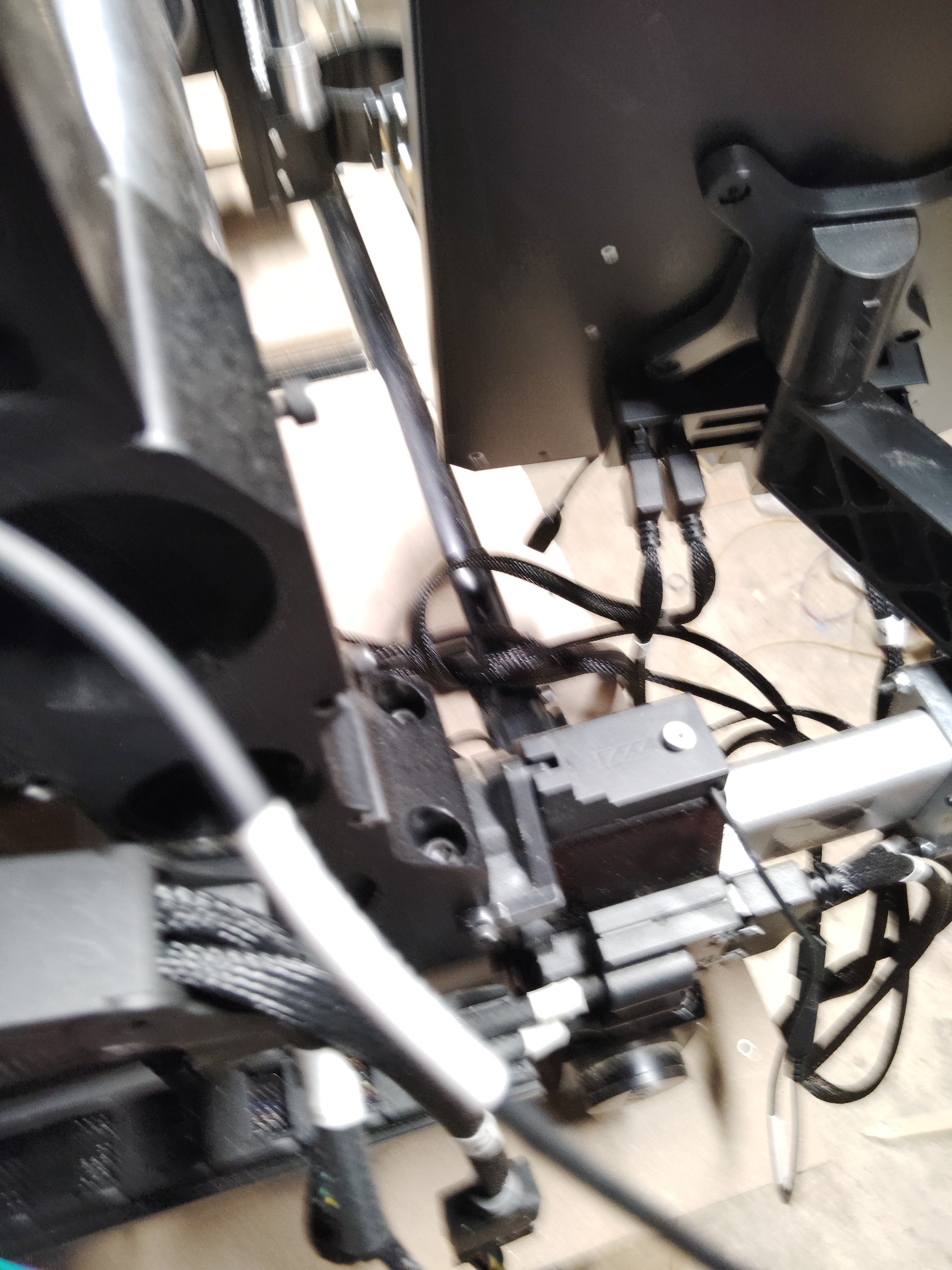

On a different note, based on these pictures, my $0.02 is that I would redo those zip ties on the Z axis homing sensor. That wire is getting pulled pretty tight and any snag on it could likely damage it.
I did that initially and ran the main cable through the slot in the plate on top of the Z-axis but ran the thin probe wire above the plate. Both together wouldn’t run through the slot and let the plate sit flat. I’ve since gotten an updated top plate for my Rowdy Roman vacuum hose boom and that one’s slot was bigger and works to allow both wires to pass through it.
Thanks, Calvin. That zip-tying was not of my doing. It’s the way things were presented, from the factory. But, I WILL take your suggestion under advisement, and see if it makes any difference.

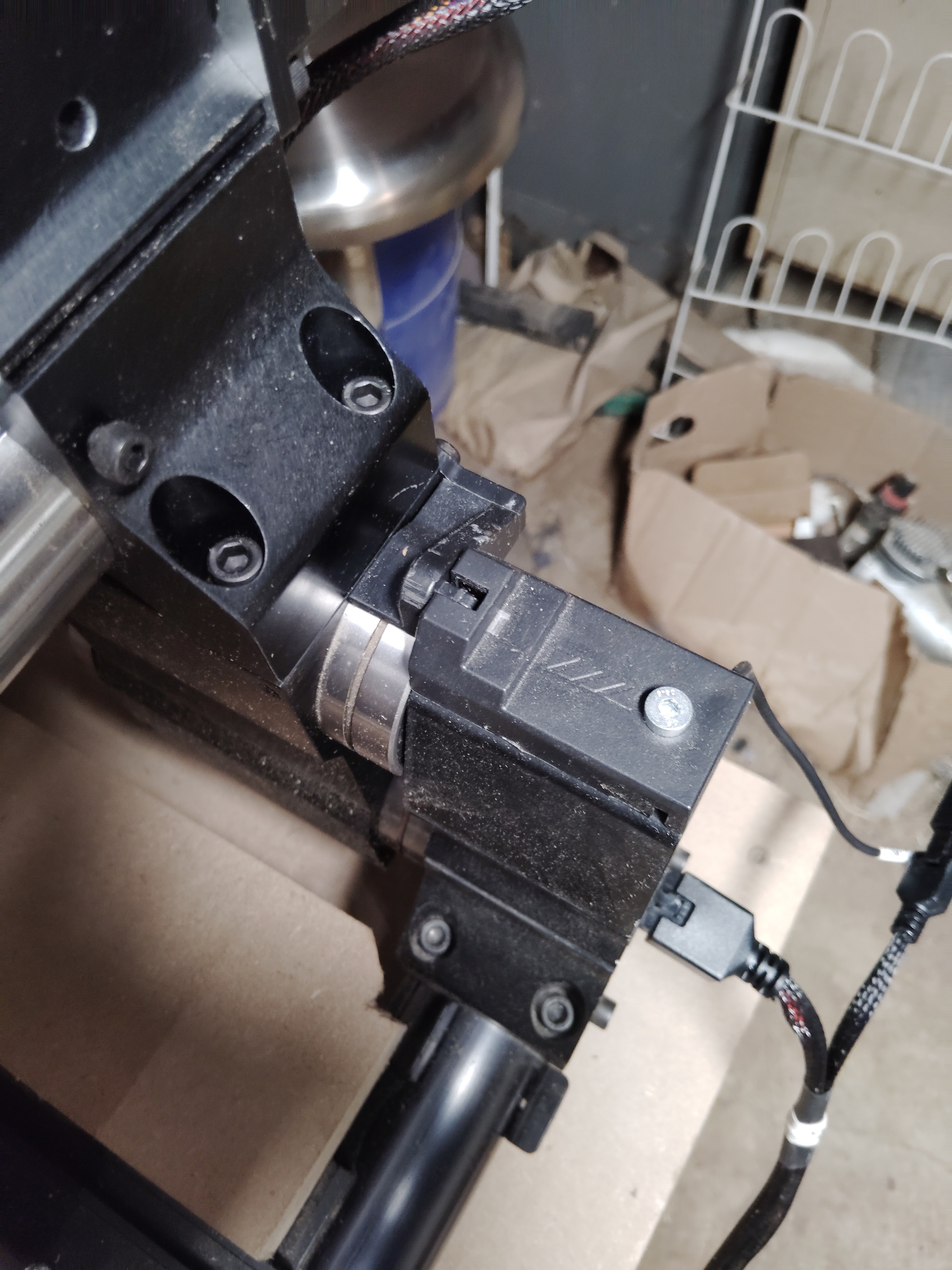

I am (despite everyone’s willingness to help me) at the point where I am beneath any hope of conquering the unsavory conditions of my CNC’s issues. As had been previously mentioned, with B-motor removed, its ball screw rotated without issue. In replacing that motor back to its rail end, I was revisited by the same former issue. A while back, Onefinity Support suggested that I ‘back out’ (a bit) the four, long, securing bolts which secures the motor to its end block. I did try that, but found that the effort didn’t manifest even the slightest change, unless those four bolts were backed just about all the way out. In fact (and without exaggeration), I had to loosen those bolts to the point where the motor could be rocked, a bit, by hand. I have detached, and reattached all wire connections, with no change in matters. I also noticed that, with a short spell of power given to the machine, the top of the X-rail motor began to become warm. Is that proper?

Before that. does the motor rotate when disconnected from the ballscrew under power?
If not. it’s either the wiring or the motor.
To check the wiring is good swap the other Y axis motor and see if you get motion. If you do not it’s the wiring if you do its the motor
Hey Ken5 - No, that B-motor does not rotate under that condition. Also, the support team requested a video of my situation, and I (just now) sent it to them. For you all, I am going to do the same, here. Following, is the link:
