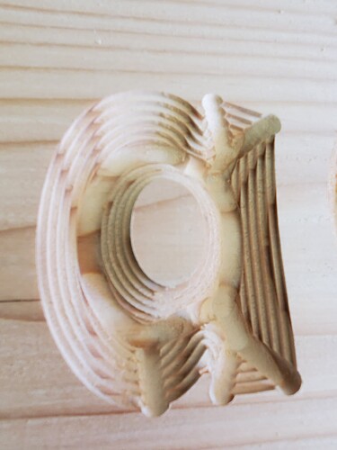

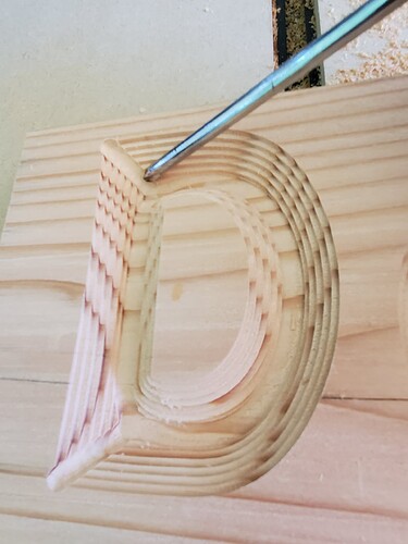

Hi all,
Loving my new, one week old, Onefinity.
I am having some fun running V Groove paths with a 1/4 endmill bit, It gives some nifty steps, which I’m sure could be programmed in, but this is a super simple way to do it.
However, the V groove path includes some cornering ( I don’t know the proper term for it ), which I would like to eliminate.

Stadium Effect Lettering! You created a new font.
Ha, I suppose so. Just need some little people.
Yes, I understand the concept, but I would like to beat it and remove the cornering.

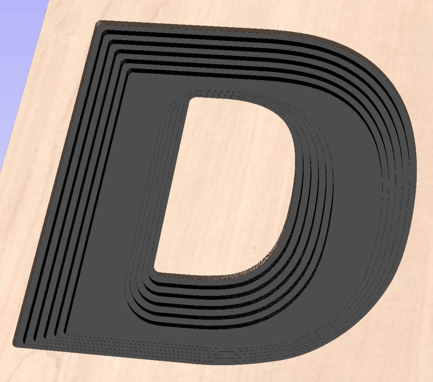

The easiest way to do this is quite simple. Just create a clearance tool path with an end mill, and run that instead of the actual carve path. The clearance tool prepares the surface for V-carving by hogging out the large areas that would take a lot of time with a V-bit. However, the cleared area will be slightly smaller than your design since you are not going back and running the finishing path the the actual V-bit.
For example:
But if you want precise sizing, you would need to use a more appropriate method (i.e., define all of the individual steps as separate tool paths).
