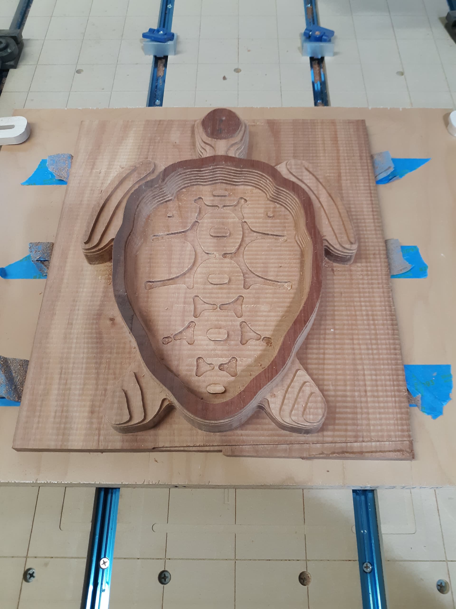

I think it turned out pretty well.
This is really my first attempt at a 3D carve.
I learned a lot on this carve, like checking the thickness of the material against the dust boot to make sure it will clear when getting to the deepest part of the carve. :crazy_face:
Also I had originally set a 1/8" ballnose as my finishing pass, but after the roughing pass it was clear to me that the 1/8’ was too short to reach the deepest part 1/2 " DOC wasn’t going to work when the material is 1 1/2 " thick.
I created a new finish path using a 1/4" ballnose.
I will need to purchase some longer bits.
not sure if a tapered ballnose would work or not.
