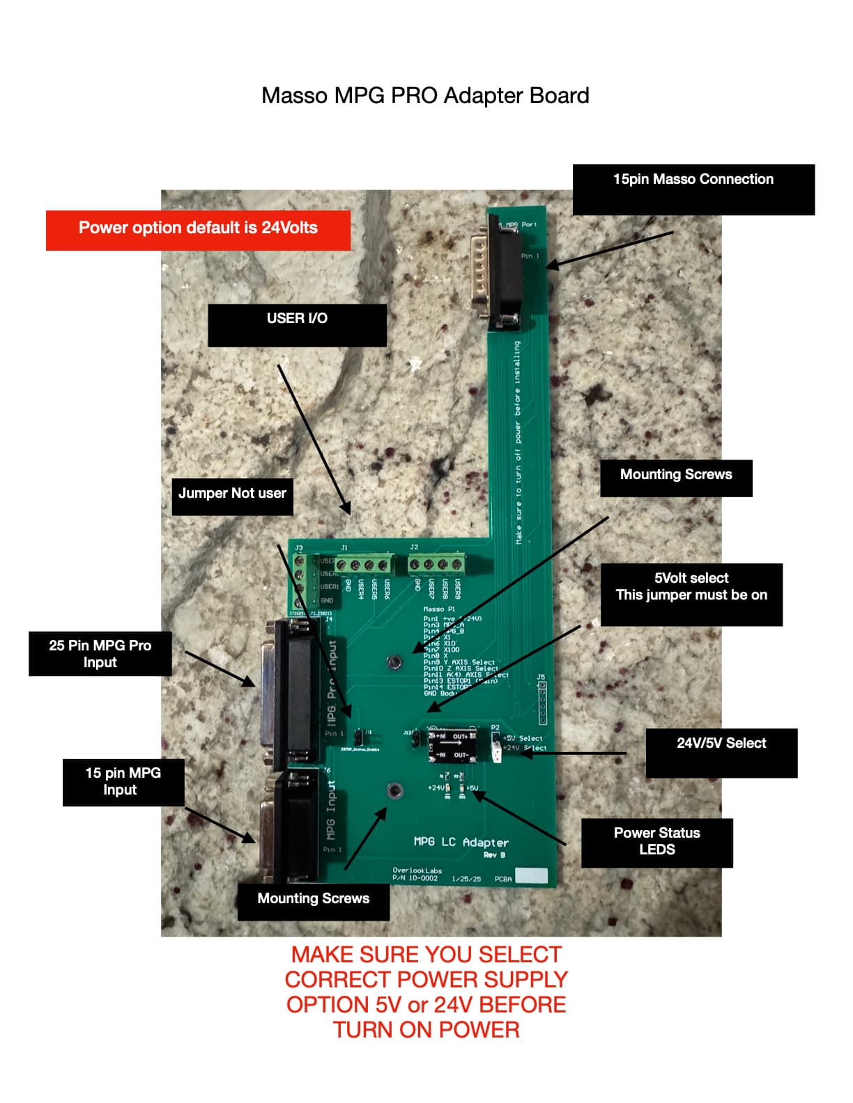

Ok so I have been working on this project and I think it solves a lot of problems and gives you lots of options. BUT now tariffs have set in and I do not see anyway to offer this to others at a good price.
This is a plug in to the masso MPG port that allows you to run with a 5volt or 24 volt mpg without removing the housing and gives you a better ground and five other functions if you go with a custom MPG vs just the 24volt masso. The 24volt masso mpg also works with this right out of the box. The mounting hole also lines up with the masso stand-off so you would just plug in the board to masso’s mpg port and mount the one screw. The only jumper is to select a 24volt mpg or a 5volt mpg.. and BAM Clean… How many should I make after the tariffs go away? I have 6 in stock
25pin 5 volt Pro MPG with 5 programmable functions. 15pin 5V or 24V mpg

Its a universal mpg adaptor interface for the masso, Allows you to select any mpg on the market 5volt or 24volt and connect it cleanly to the masso 15 pin connector without removing any connector housing.. It also has a better ground connection and provides the user to trigger 5 other functions if you convert your mpg with other push buttons and convert you 15 pin mpg to a 25pin, like I did with my mpg pro design in the photo above

A lot of the other ones are compatible as long as you are willing to rewire the MPG and or find an alternate power source.
In most aspects I also agree with you. You should not even have had to open the Masso controller to add an MPG, They could have done exactly the same thing with the DB-15 connector that they did with the USB, add a simple extension cable and have it connect to the outside of the enclosure.
