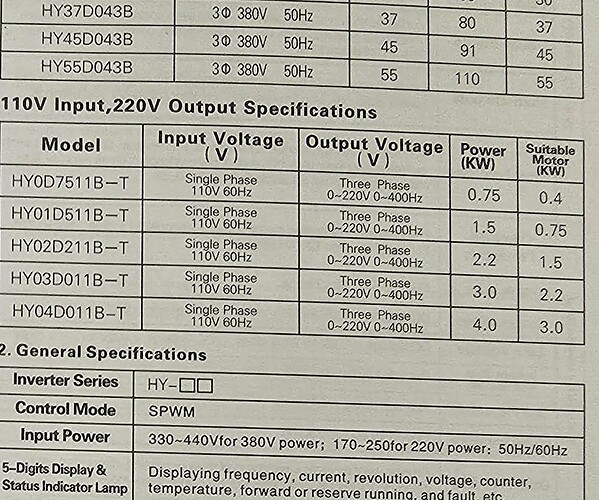

Well this is interesting. Unlike their 220V VFDs, the part number and the label on the 110V VFD’s refer to the input power, not the motor power. The HY0D211B should be used with a 1.5 KW spindle maximum. It still needs a circuit with a minimum 25A breaker. Since this requires installing a special branch circuit anyway, I don’t understand the point of choosing “110V” circuits for higher powered equipment like this.
To run a 2.2 KW spindle one needs a 3 KW motor, with a minimum 35A breaker for a “110V” circuit.

Hey Barry,
those are the Huanyang “B-T” Models with the step-up converter. They can convert 110 V to 220 V internally. Usually they are too expensive to make sense since in most cases you would simply use 240 V.
That a motor that produces 1.5 kW mechanical power at the shaft usually draws 2.2 kW apparent power is normal, but this is still the output side of VFD.
I still see neither input power nor input current of the VFD specified.

Hey all,
here another 110 V example with the input current (Ampères) rating omitted.
