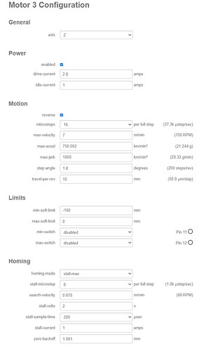

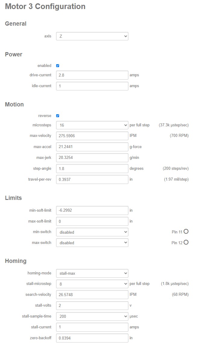

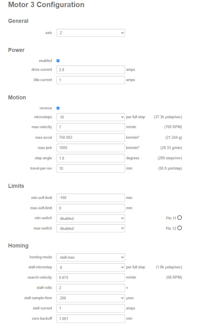

If you do not wish to install firmware, match the settings below.
Imperial:
Metric:
